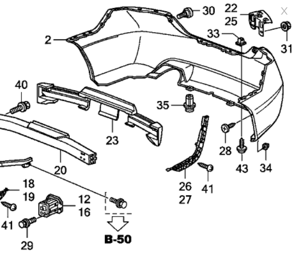

I have an 09 civic and the rear bumper where is connects to the metal fender is missing clips, not sure what happen to them. Can these be replaced? I have search online all over but can't seem to find what I'm looking for.
I'm no wizard at searching stuff up so any help would be much appreciated....

Not sure which one you're talking about, I'm guessing reference number 35? That has part number 91503-SZ3-003.
For future reference, basically every Honda parts dealer site has drawings like that one. This one came from HondaPartsNow.com.

I believe it's part 26 that I need, thanks for the diagram helped a lot. That is the part that the bumper would clip into right?

26/27 screw into the sides of the fender, then the bumper clips into them. I believe item 43 also goes through them.

those are the parts I need but for bother sides, dealer wants $22 for each.. where the best place to order parts in Canada with reasonable shipping time?

Take the part number and Google search. Sometimes you can get them on Amazon for a reasonable price. Sometimes it's best to go to the dealership and order.
