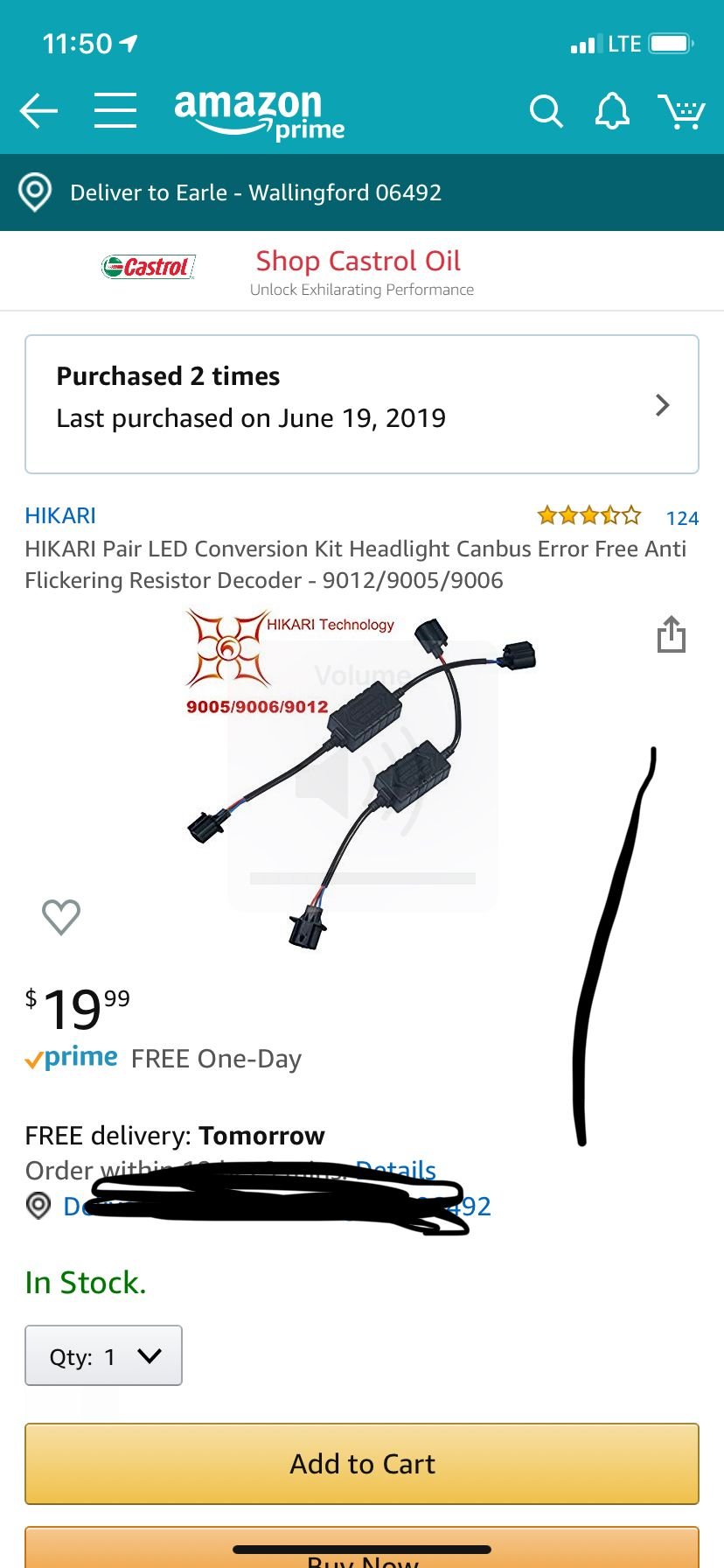

These are the resistors that I’m currently using. They sent me another pair. Should be here tomorrow. I’ll ohm them out when they arrive. And will them compare to the set in the car now. They recommended using 2 per bulb. I’m currently only using on the hi beams. Should I use them on the low beams also.
and yes it has lights on the camera that turn on at night

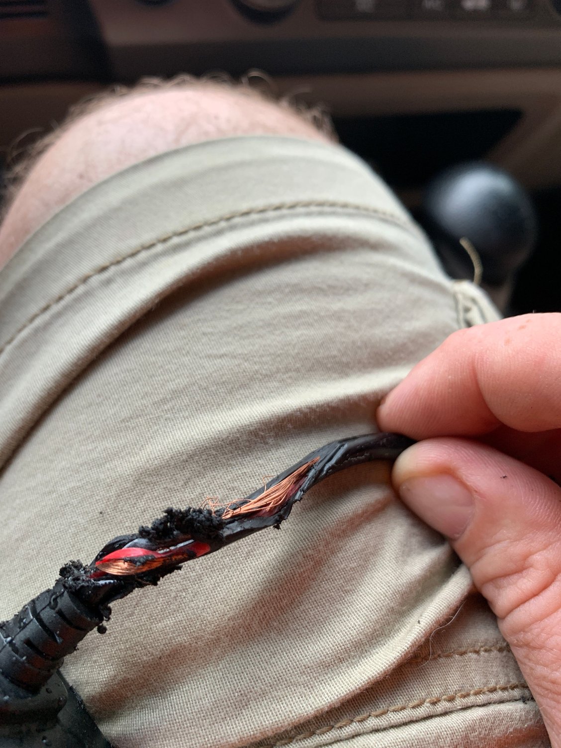

Well I found the problem. I don’t know how I missed it the first time. Must not have been as bad. It was rubbing against the belt. Guess I’m not ready to take on anything much harder than basic maintenance. Lol

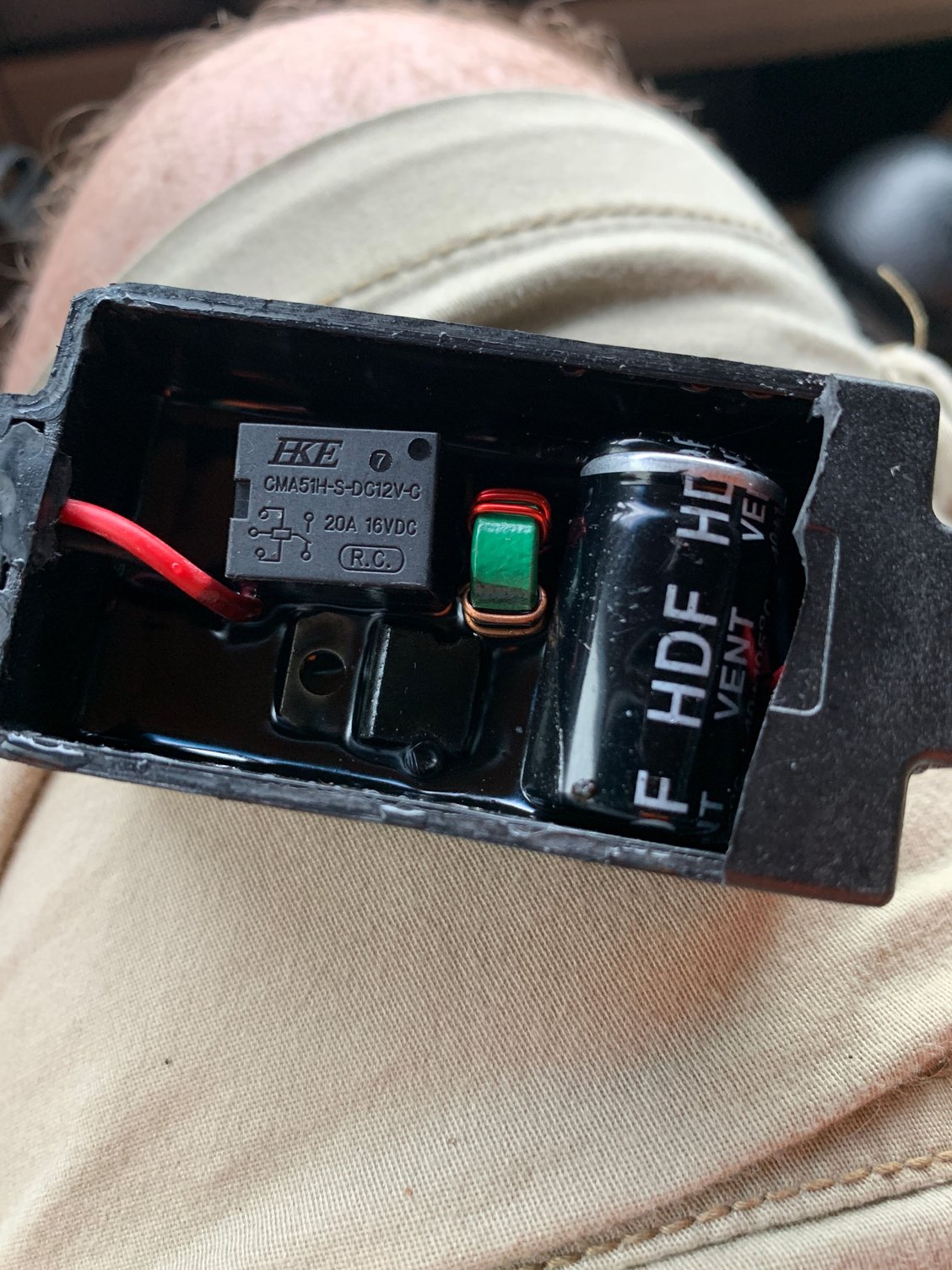

anyways the new resistor is installed. And properly mounted to the car. I opened up the old one after realizing it was trash.
Is this Cap decoder?

that thing on the right looks like a capacitor (cap), left side a relay, and a coil in the middle
glad you figured out the problem, always check if wires can come into contact with something when installing stuff

Ooh that looks painful (for the wire). Glad you found the issue, and yes that looks like a capacitive decoder!
