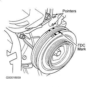

To check mechanical timing:
1) Remove all spark plugs..makes it easier to rotate engine manually
2) Set #1 cylinder (closest to crank pulley) to TDC
3) Remove valve cover. Notches in cam gear should be parallel to top of cylinder head.
"UP" mark on cam gear should be at or close to 12 o'clock position..though the "UP" mark is not considered a timing reference.
4) Crank pulley's last (counter clockwise rotation)/most seperated timing mark should be aligned via site marks on lower timing cover

I removed valve cover and timing belt top cover. The marks seem to line up perfectly as per your diagrams.
