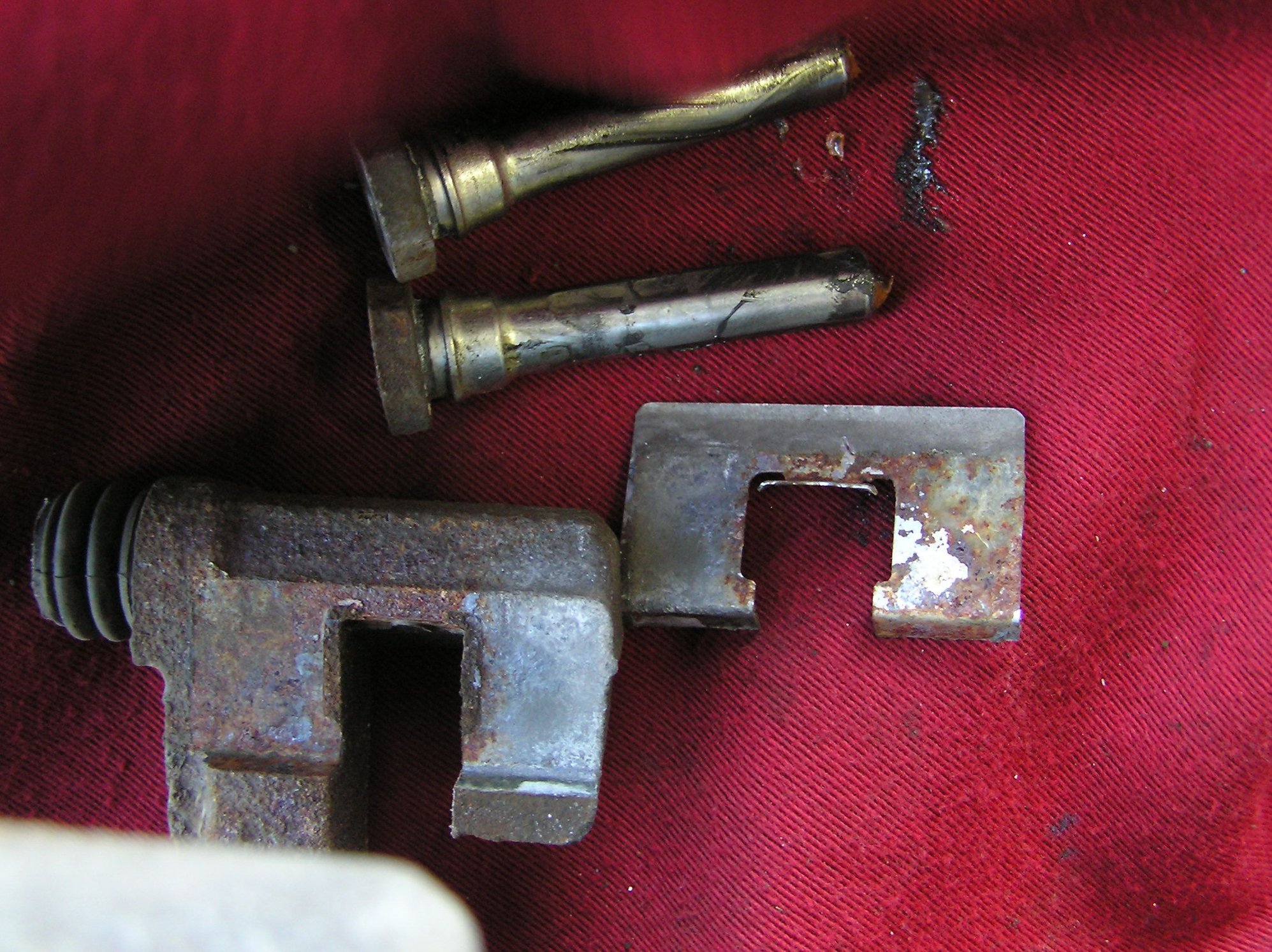

If pads are seized in the brackets, remove the brackets remove stainless clips and grind out the rust buildup between the clip and bracket, and wire brush the clips.
All 4 areas on each of the 4 brackets. I coat the freshly ground cast iron with silicone grease before reassembly to protect the thing from rusting.
Example rust pic:
