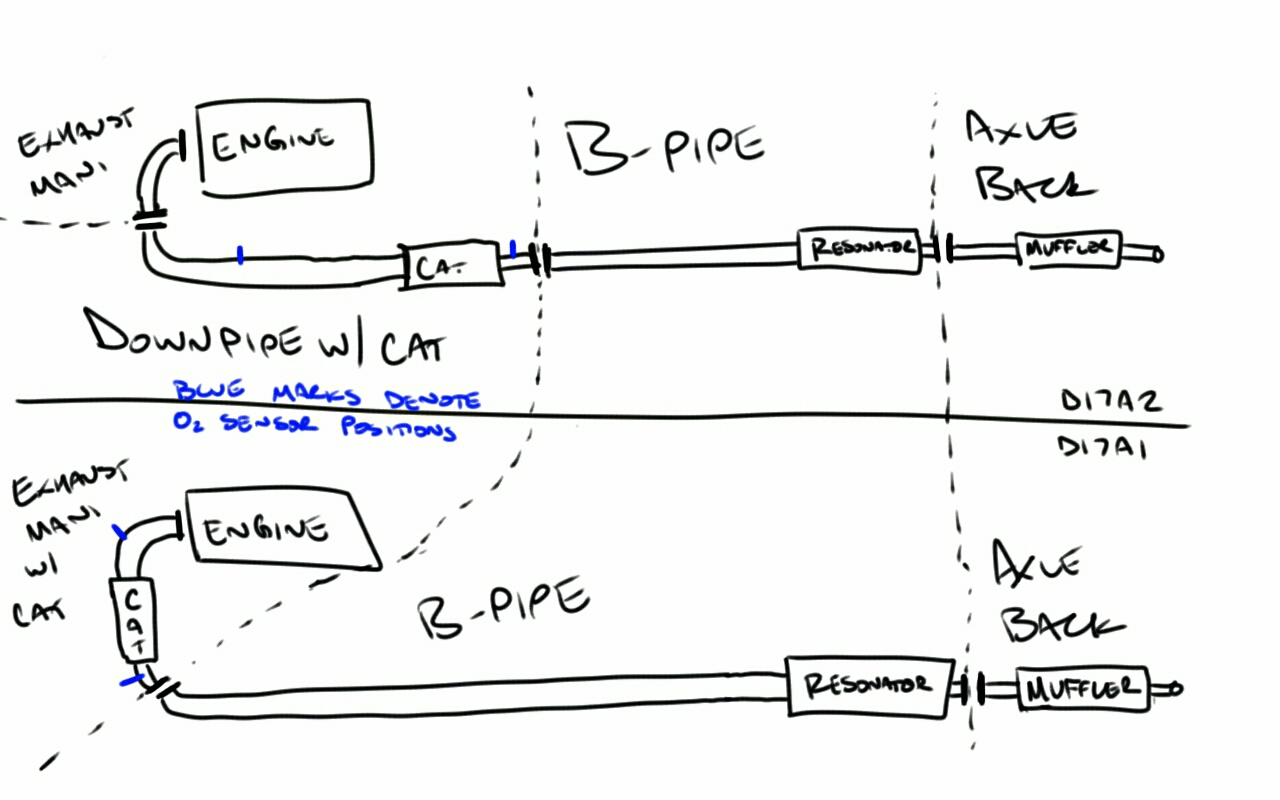

i keep finding this image for 2002 civic EX... no 02 sensor?

not on the header. The cat on the ex is located below the car on the downpipe
an illustration of the differences between the dx/lx and ex exhaust systems I drew up a while ago

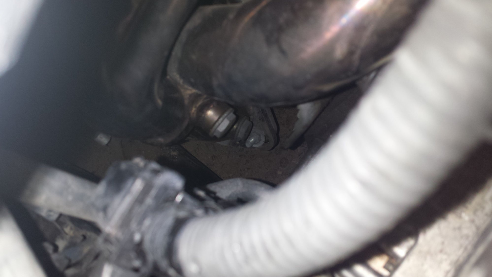

that drawing is great... thanx.. i wonder if the vtec even has an AIR/FUEL ratio sensor...... your drawing also shows one sensor on the catalytic converter.. is that accurate? btw... heres the header on it...

i just confirmed D17A2 engine. and found the 02 plug tucked under the subframe near lower firewall.. and other plug near thermostat.. with brackets to run the 02 wire.. straight pipe after header with no holes for 02 sensors..
