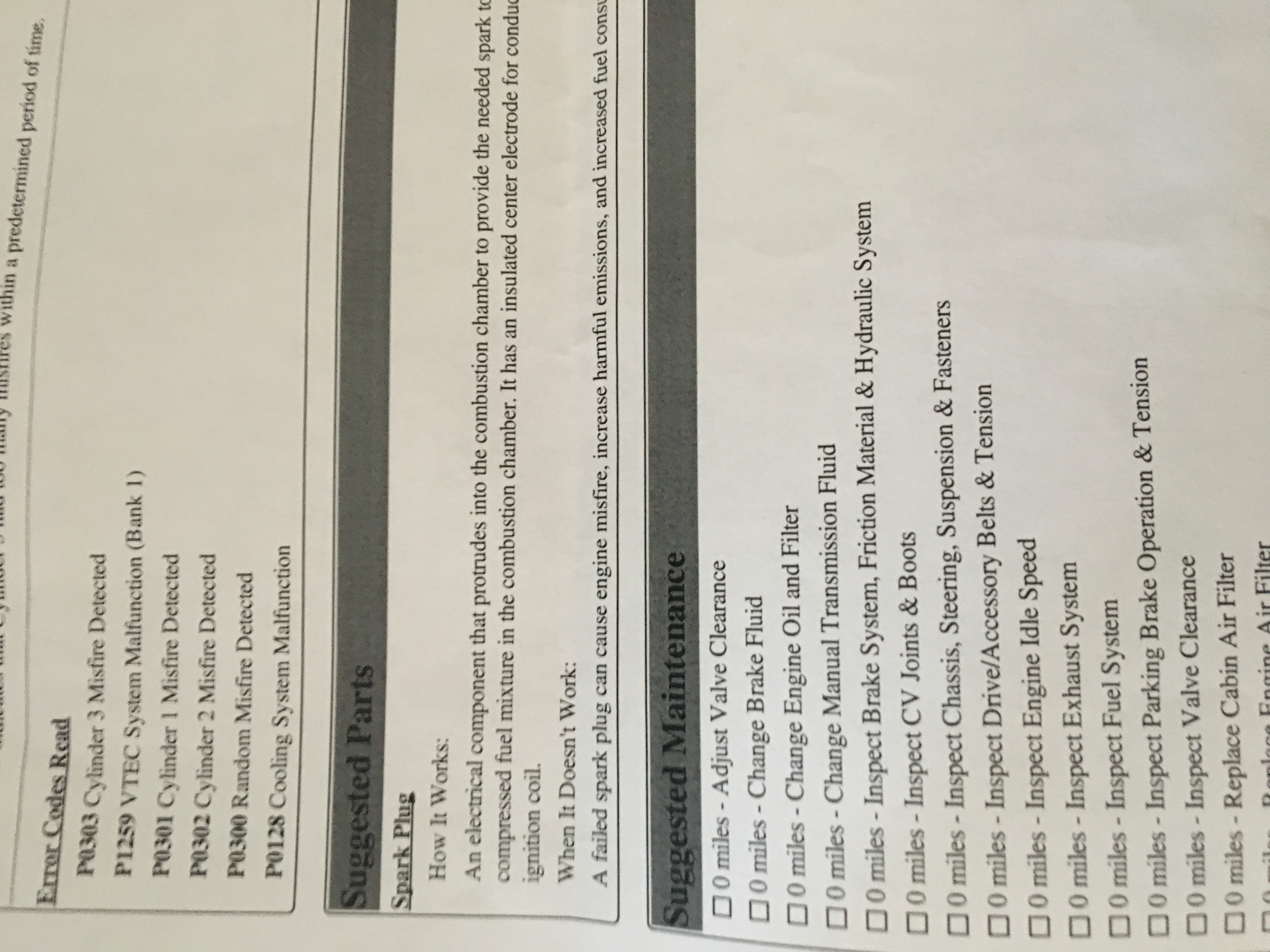

Error codes:
P0303 Cylinder 3 misfire detected
P1259 Vtec system malfunction (bank 1)
P0301 Cylinder 1 misfire detected
P0302 Cylinder 2 misfire detected
P0300 Random misfire detected
P0128 Cooling system malfunction

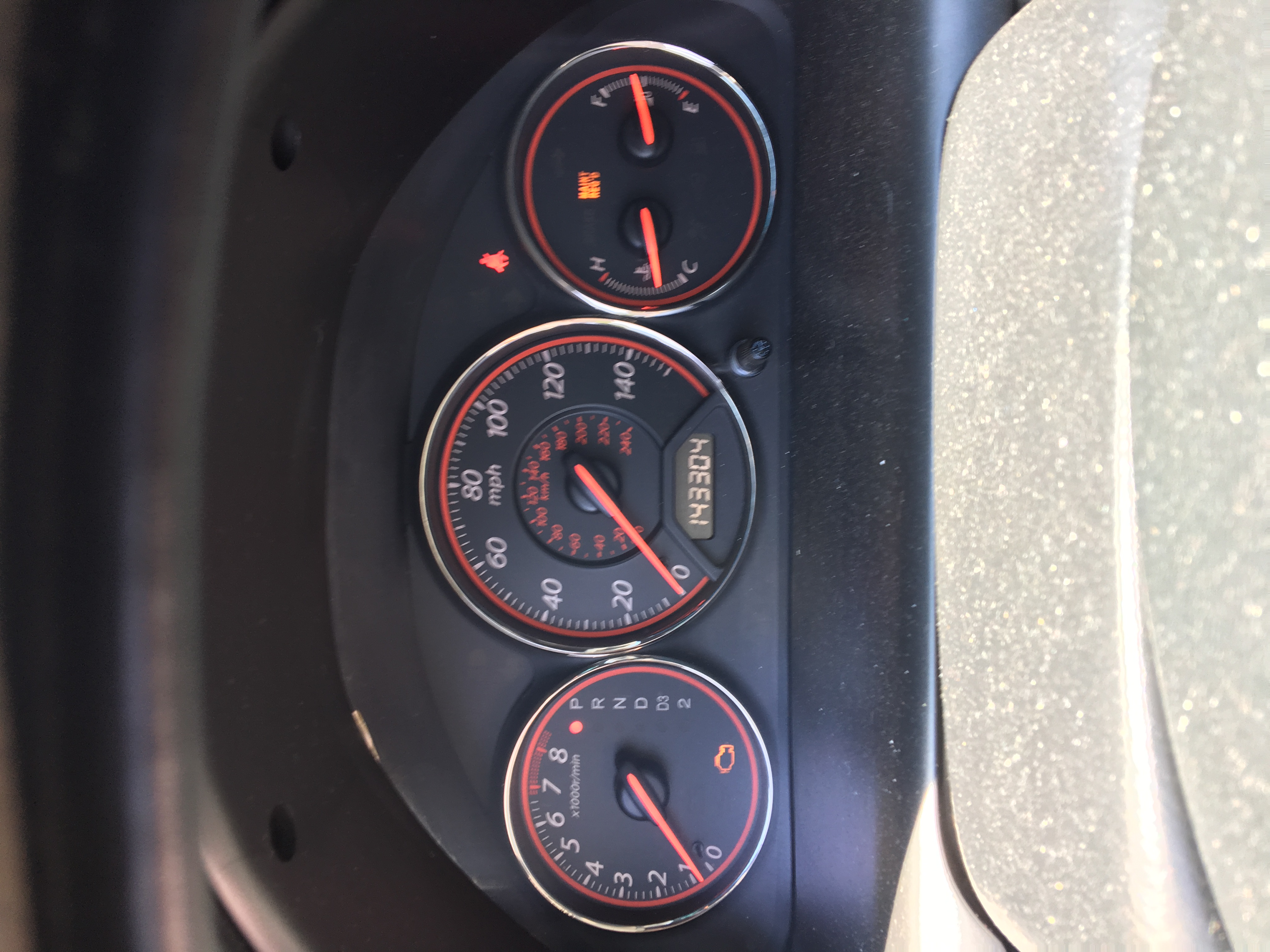

I keep getting check engine lights for the past 8 months now.
I change the oil every 3k miles. Some say it may be faulty fuel Injectors or a bad ecu for the Vtec Malfunction. Whats funny is that the honda mechanic said I have no vtec at all in my car. I can rev past 4k rpms no problem I'm afraid that it will begin to not rev past that part in due time. I need some help please, greatly appreciated.

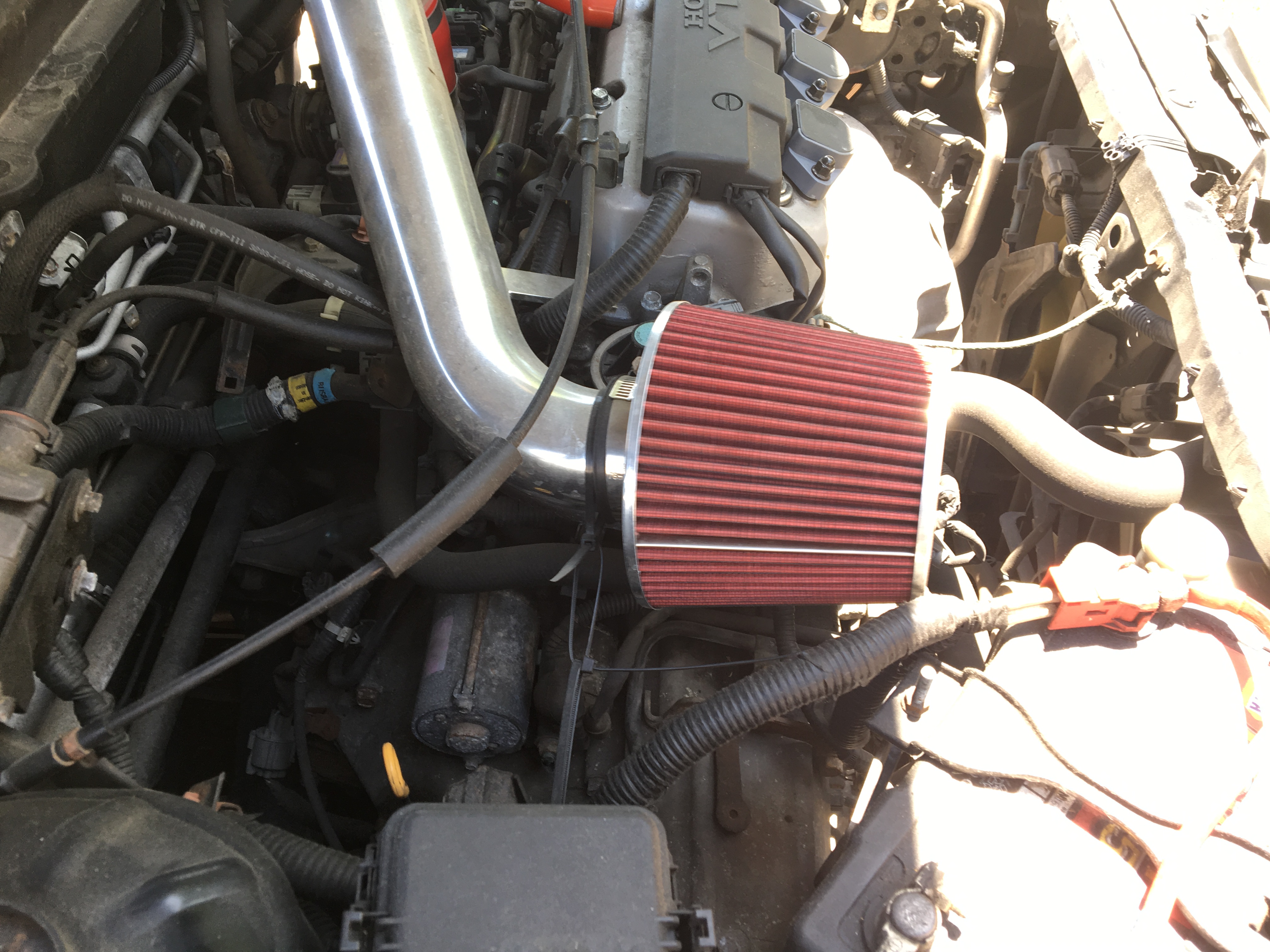

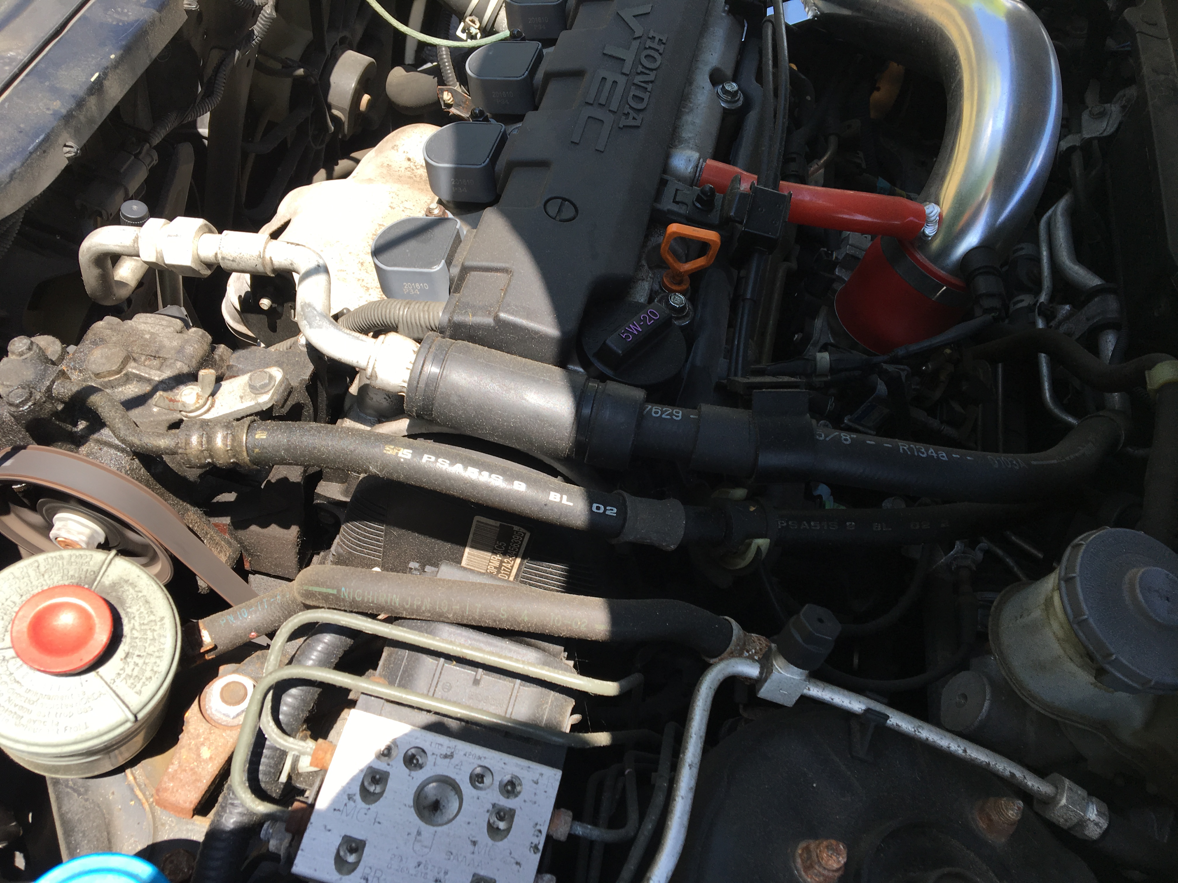

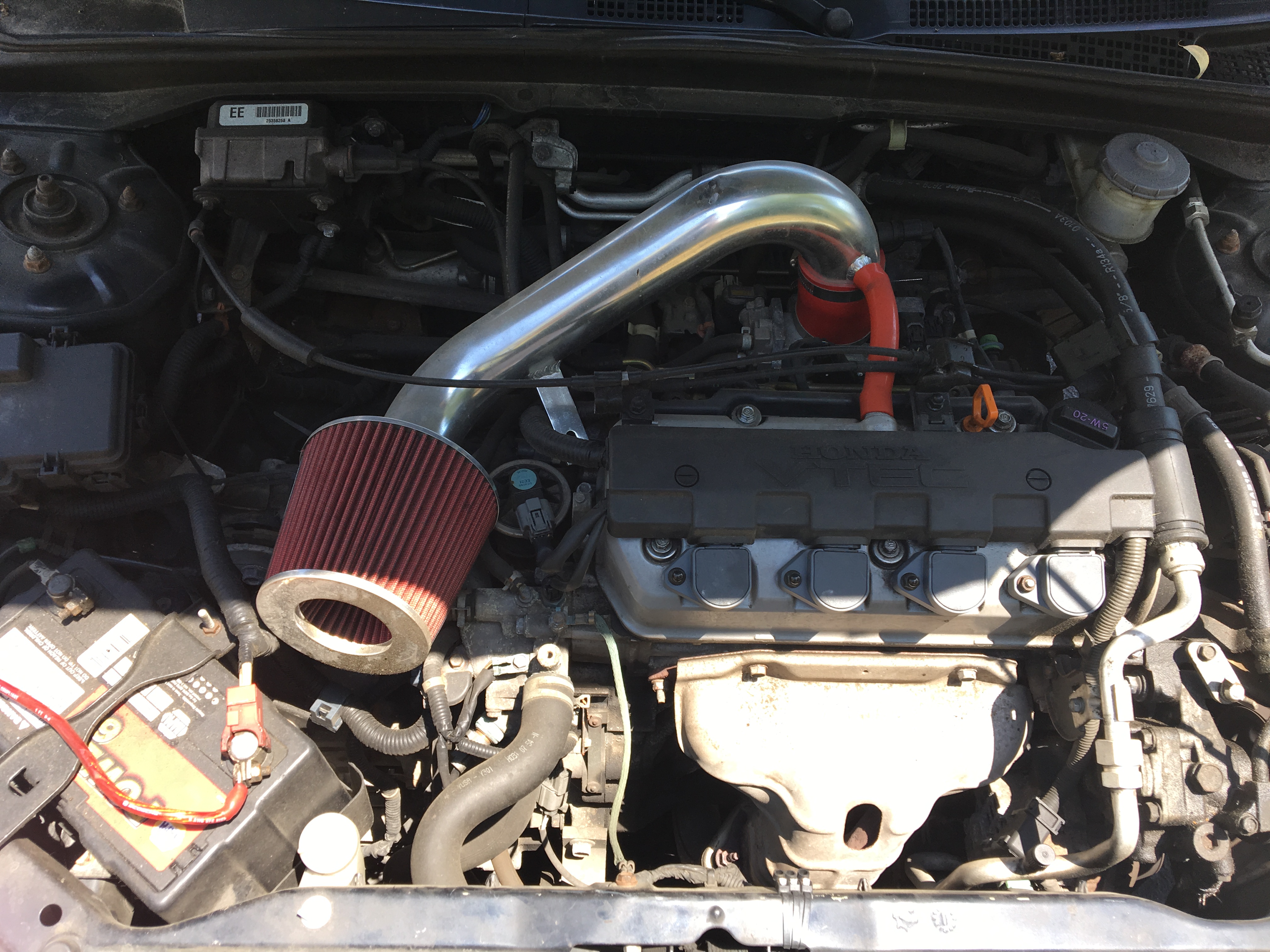

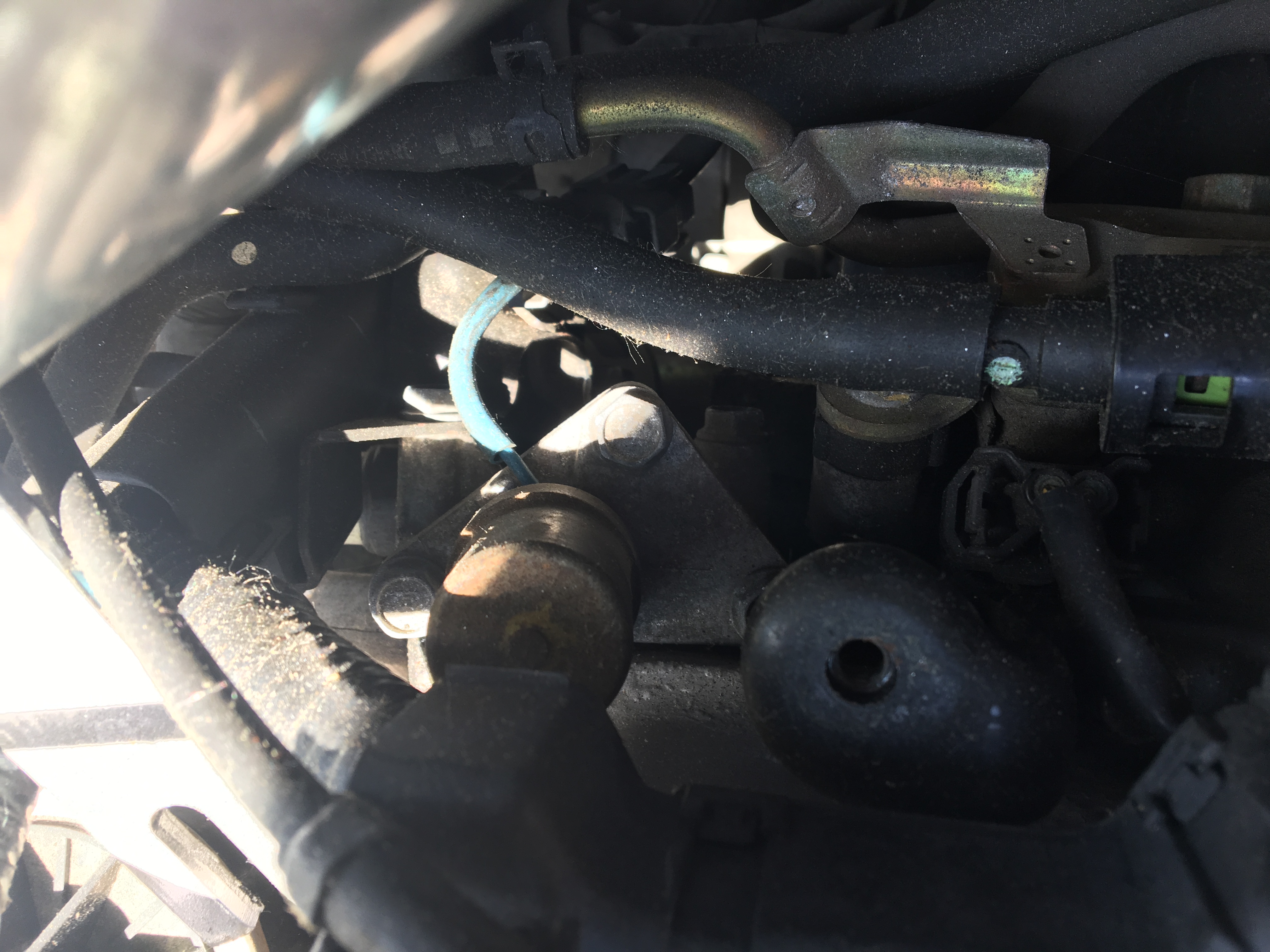

4) Picture of your engine showing the VTEC solenoid, or you need to verify it does in fact have the VTEC valve assembly attached to the cylinder head.

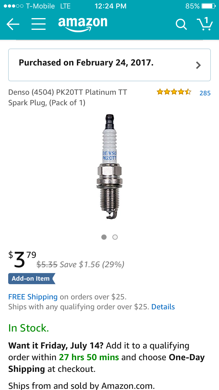

3) Denso spark plugs with factory gap which is 11 1.1mm tip

About the vtec solonoid, I do infact have one. I don't know why a honda mugenast mechanic told me otherwise which threw me off a bit, so my car has to be vtec.
I see the pic of the VTEC valve too. It even screams VTEC in the plastic cover on top of the engine. The mechanic is broken and needs replaced?

Maint Req'd light is on. How far overdue is your oil change? How many miles did it take for the engine to LOSE 3 QUARTS of oil?

The Denso plugs are fine. Not quite the exact plug called for (PKJ20CR-M11), but probably close enough for government work. No need to buy more.
