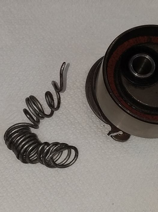

2002 Civic EX. 142k miles. SOMETHING caused the tensioner spring to get completely ripped out of the hole in the tensioner (see pic). Replaced water pump/serpentine belt/tensioner. Now have check engine light and only code is P0456 (very small evap emission system leak). It also takes forever to start.
Ya, that's normal wear. THAT'S why we suggest replacing it long before this happens.

Never mind. Auto Zone gave me a printout of a vehicle that just had it's code read and he apparently didn't clear out his code reader. It was crank sensor, which is what I expected. P0336. When the water pump seized, part of the belt got torn backwards and it would have easily damaged the crank sensor, but at over $100, it wasn't one of those "I might as well change it while I'm in there." Fortunately, I only need to remove the two belts on the pulley, the pulley itself and lower timing cover to change it.
