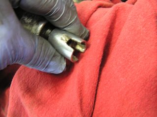

Forgot to say: Many thanks are due to whoever posted a picture of a home-made wingnut socket, by the way!
It works great on many spare tire fixtures as well.

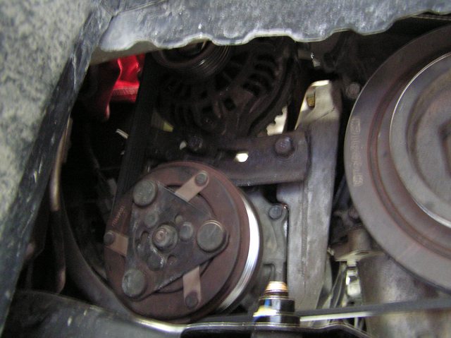

I just use a big prybar to shove the alternator to tighten the belt,
MAYBE spin the jackbolt in with my fingers to hold it in place,
then tighten the bottom alternator bolt to lock it in place.
All accessed through the wheelwell.
If I didn't use the jackbolt to hold it in place above, I now spin it in by hand so it can't fall out later on.

Thanks for the suggestion to pull the wheel and get at this all from the wheel well. The A/C ain't working, so it's a good bet I'll be trying to get at the bowels of the engine bay again sometime in the near future. Probably after I read a bunch of threads to figure out what my steps to diagnose it are.
