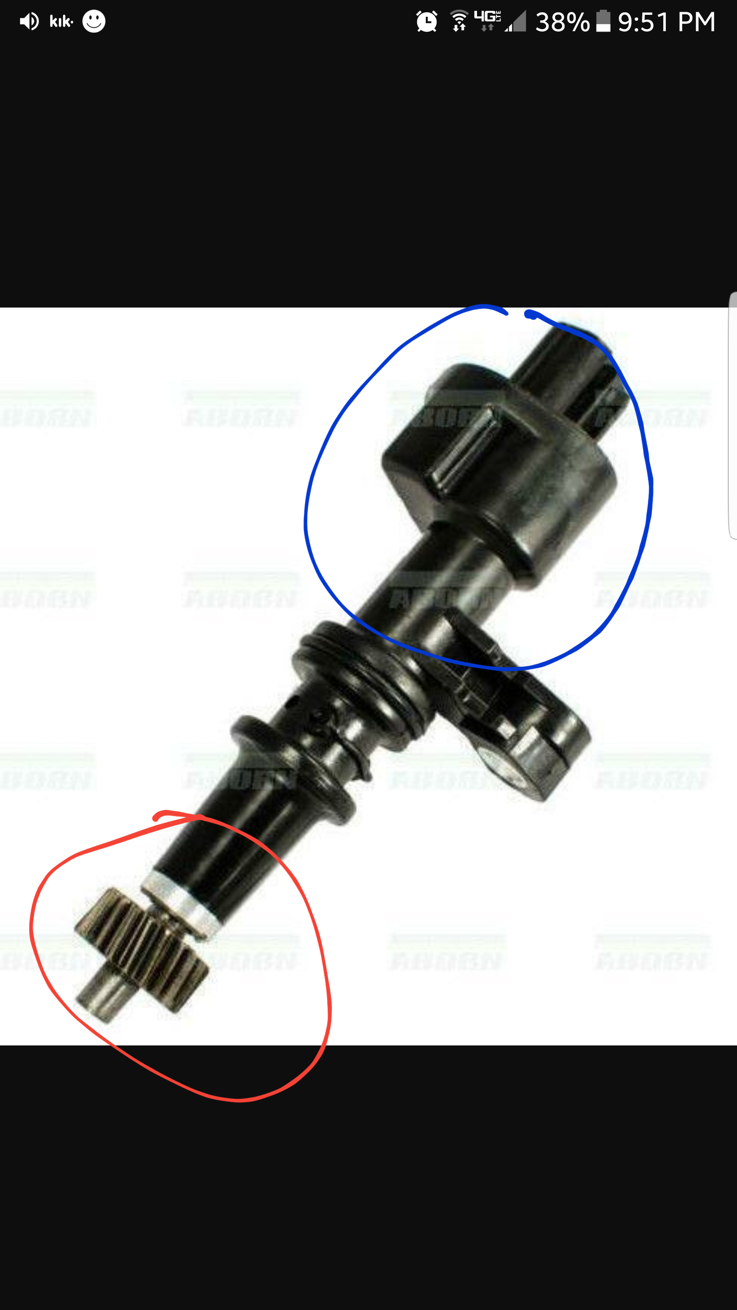

WHAT broke in half? Where are the pieces?
Remove sensor,
Inspect gear on the sensor. Is it AFU? If it's ok then
connect sensor to wiring, spin sensor drive gear by hand while you watch the scanner, or while someone else watches the speedometer. Does it work?
If it will run the speedo this way (spinning it by hand) you verified it will work if the trans will spin it....so prob must be inside trans....?
look down the hole in the trans to see if the drive gear is missing from the diff carrier.
I've not seen a drive gear break, but that's me.
Where I circled in red is what the sensor looks like and that drive gear is still there but with the eBay sensor where I circled in blue is where it broke off into 2 pieces.
