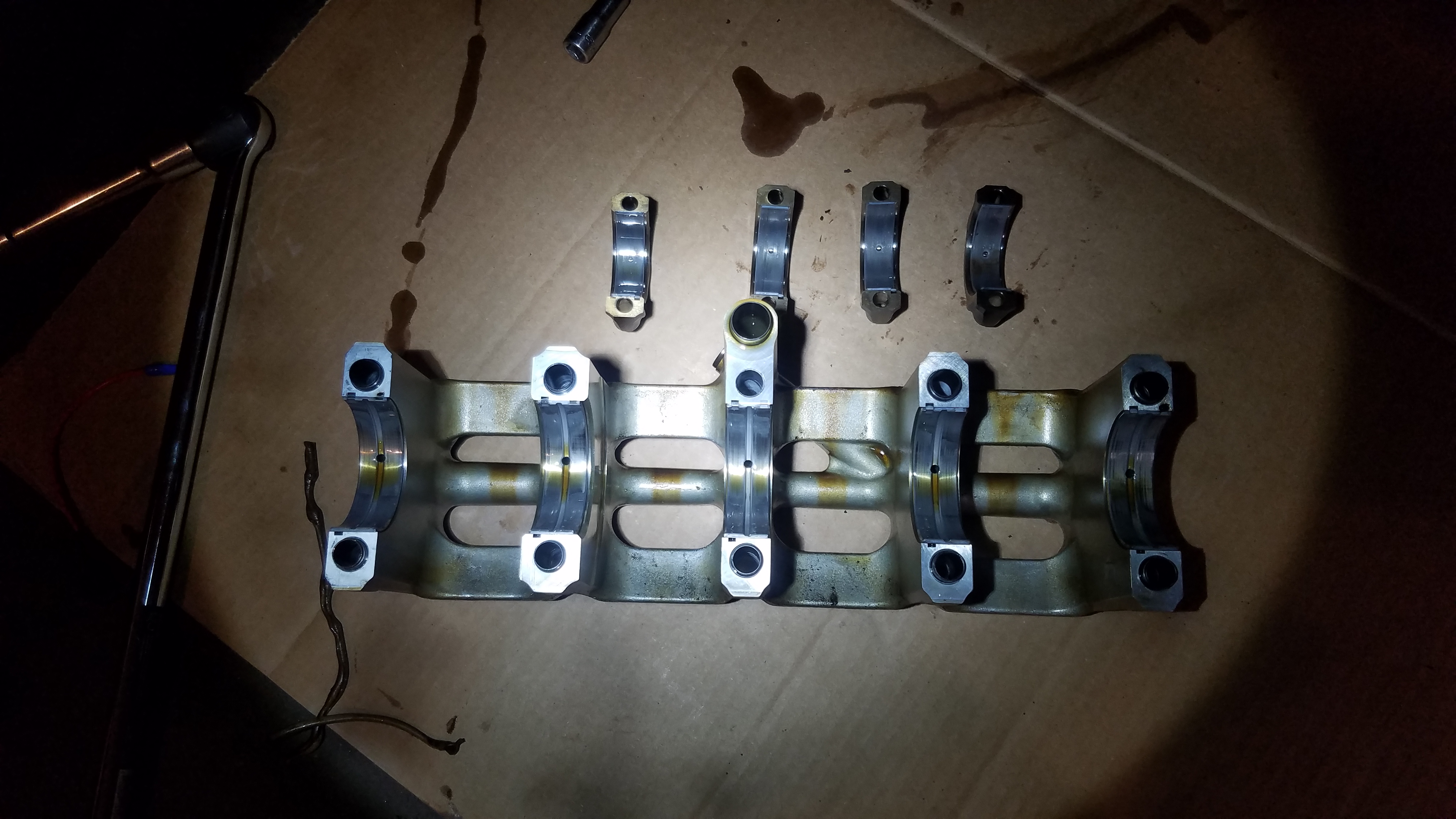

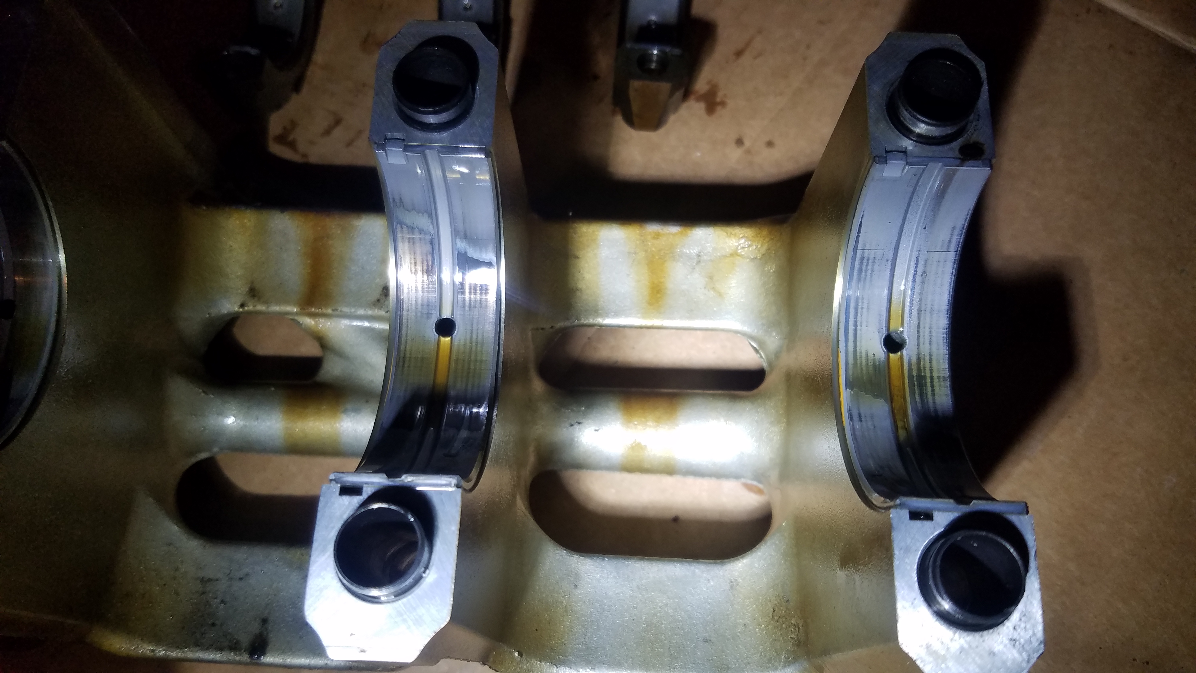

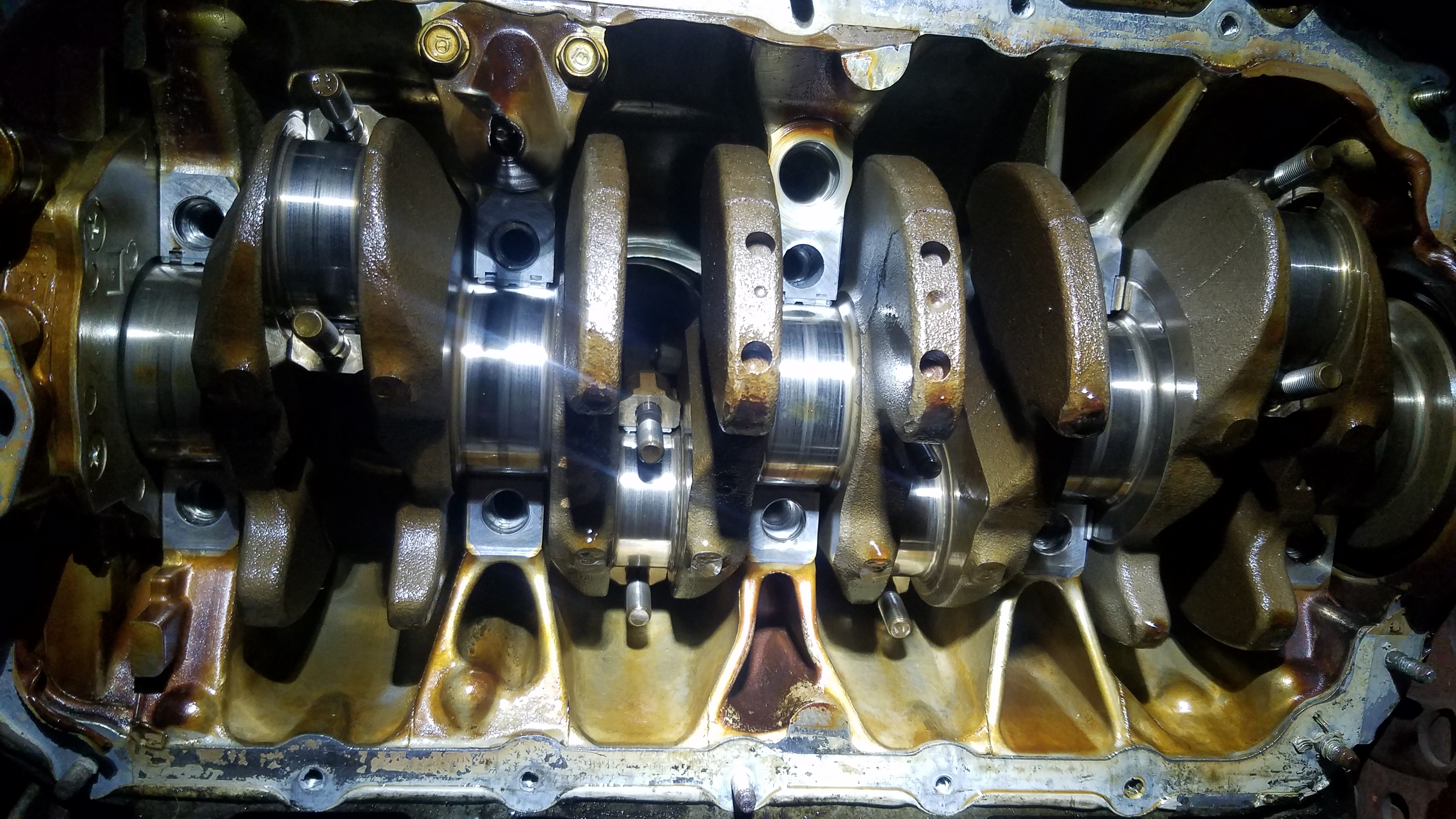

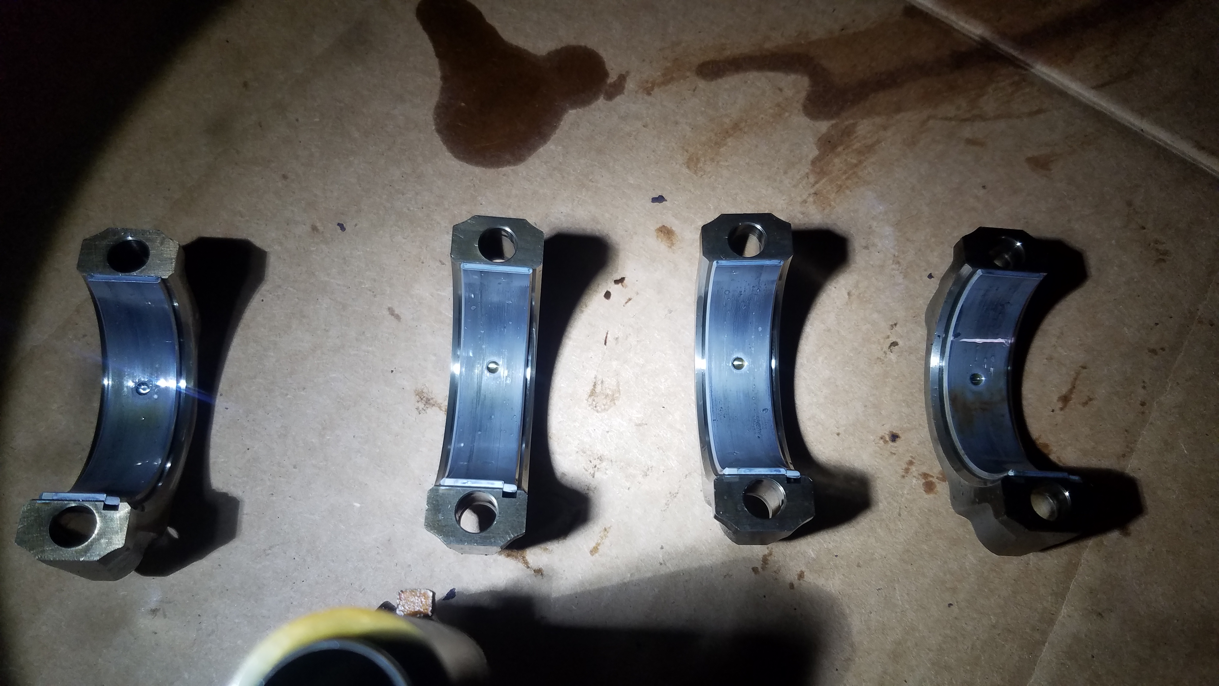

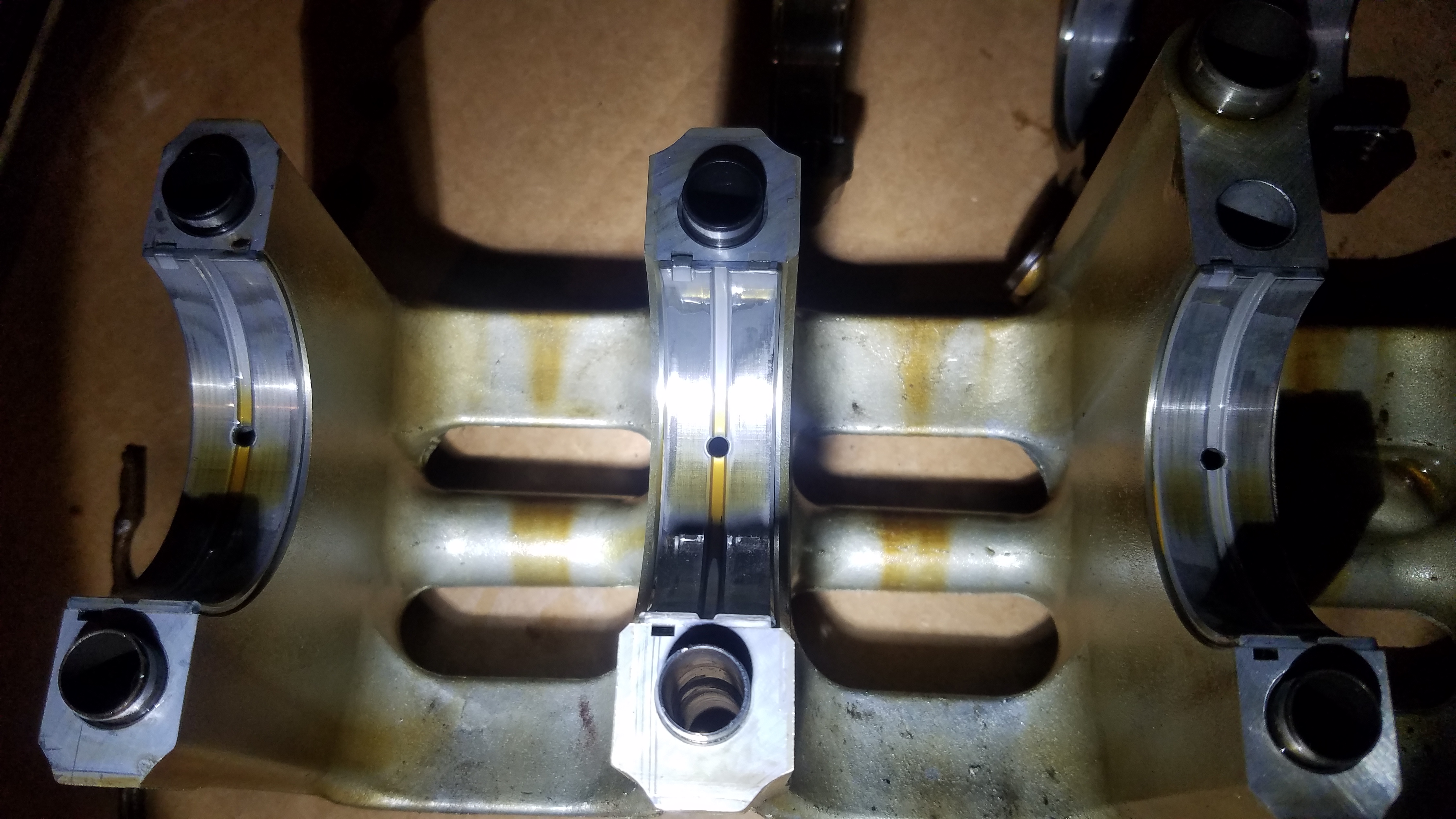

So quick background, bought a 2002 Civic EX with 124k miles for my sister. Soon after she overheated it and had it running at over 260* for 2-3 minutes.. Needless to say she blew the headgasket, had a shop check the head and deck it and they found no problems. Replaced the headgasket and timing belt and a few other things and it ran great. For about another 1000 miles.. Now it has a knock in the motor.
Here's the thing, the sound is intermittent and it has no rhyme or reason to start or stop. I pulled the top end back down to the timing belt and found nothing loose or something that would cause that noise. Pulled the oil pan off and all the bearing caps and found nothing else. All the bearings are in decent condition for the wear and tear you'd expect. Clearances were all tight so this is seriously throwing me for a loop. Torque converter bolts are tight so that doesn't seem likely. I'm about to sell this car for scrap but we've only had it for about 3k miles.
What the hell else could it be? Everything seems fine!
I don't see anything scary in those pics right off the bat...Internal noises (bottom end bearings) are usually pretty dang consistent once it starts and doesn't go away.
Post up a good recording so we all can hear the noise?
My laptops suck for sound reproduction though.
Use a stethoscope to pinpoint a noise source?
Alternator mounting bolts and the 5 big bracket bolts all tight?
Compressor pulley bearing isn't going bad?

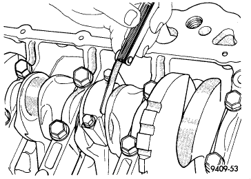

Bought a new feeler gauge instead of the old one I had and checked the connecting rod clearance.
How does a person use feeler gauges to measure rod bearing clearance?
Unless I missed something in your pictures, the bearing shells pictured in the first post look a whole lot better than your numbers seem to indicate...so.....
measuring between 0.011-0.013. I looked it up and it's supposed to be in the 0.002 range
WAIT WAIT WAIT
Are you mixing up metric and standard measurements?
Because this looks all effed up right now, isn't making sense in my little pea brain yet.
If you used them to check side clearance (also called end play), side clearance won't make the horrible rattle noise.
To measure oil clearance between the crank and bearings, you typically would use Plasti-Gauge
or use inside and outside micrometers to measure the diameter of each part and calculate the difference.
