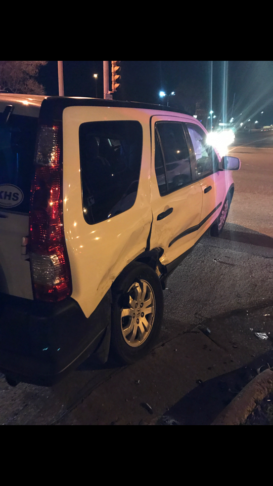

Last Saturday night, 16 year old granddaughter driving the CRV with 115K on it had a car come from a side street at her side. Everyone one was going slow enough that she tuned hard left but rear of CRV spun on around and he caught her in back right door and rear quarter panel with a glancing blow. The back wheel is cocked around at an odd angle. To make matter worst, she then went over a curb before stopping. The right side air curtain deployed even though she was alone. All 4 tires are still up.
Car looked and drove like brand new. Interior was covered with western terry towel seat covers that RIP made and interiour looks like brand new. Purchased new and maintained and garage kept. Appears NADA is $7500. even though last personal property from city said $9500.
Of course I am in Mexico. Insurance told GD it is totaled. Hard to believe. Never had to ever deal with insurance before. Not sure what they are basing value on.
Know one thing, someone will sure be lucky if I loose car over this with all the good parts on it. Insurance will surely sell it and recover most of their money? You think?
Any thought. Will try to post pictures if I can get them off messenger on my iphone to my pictures. Nissan sure opened up. GD said she saw him coming slowly but just kept speeding up like not seeing her.

That looks almost like my old civic that I wrote off in December. The rear wheel wasn't as cocked on mine
Up here, once something is over 10 years old it's almost always a write off.
Plus seeing your pictures and the unibody/frame/suspension mounting points damage I can't say I'm surprised they wrote it off.
It's too bad they're going to write it off, but I'm glad your granddaughter is ok

It is hard to see in the attachments above but that part on the ground in front of the rear tire is that large pipe type material lower control arm that has the bolt that holds it in the suspension. Bolt is completely missing.
The person who hit her was flying down the ramp making a 90 degree left turn. Says his light was green of course. So his word, her word with no witnesses. He was delivering a pizza in a brand new car no less. His air bag went off. You can make it out on the dash I think. Does not look like it came out of steering wheel. Is that how they make them now?
GD actually did not know where he had came from since she got hit so hard. She had first thought a car had got her from the direction she was left turning across.
Odd how it sheared bolt rather then ripping out of that sheet metal bracket it bolts too.
Was it designed to do that or is that bracket it bolts too designed to be able to repair/replace it by welding in a part?

I can't tell much from your pics but I snapped a couple pics under a same-generation CRV today, maybe an 02 or 03:

I was thinking it was a bolt but now I am scratching my head. Obviously, that attachment is a weldment, made as one piece, wrapped in rubber and rolled into the arm mount and welded onto the arm. It only comes mounted to the arm.
Arm on car still has mount and rubber in it. The attachment with the flats is totally gone.
