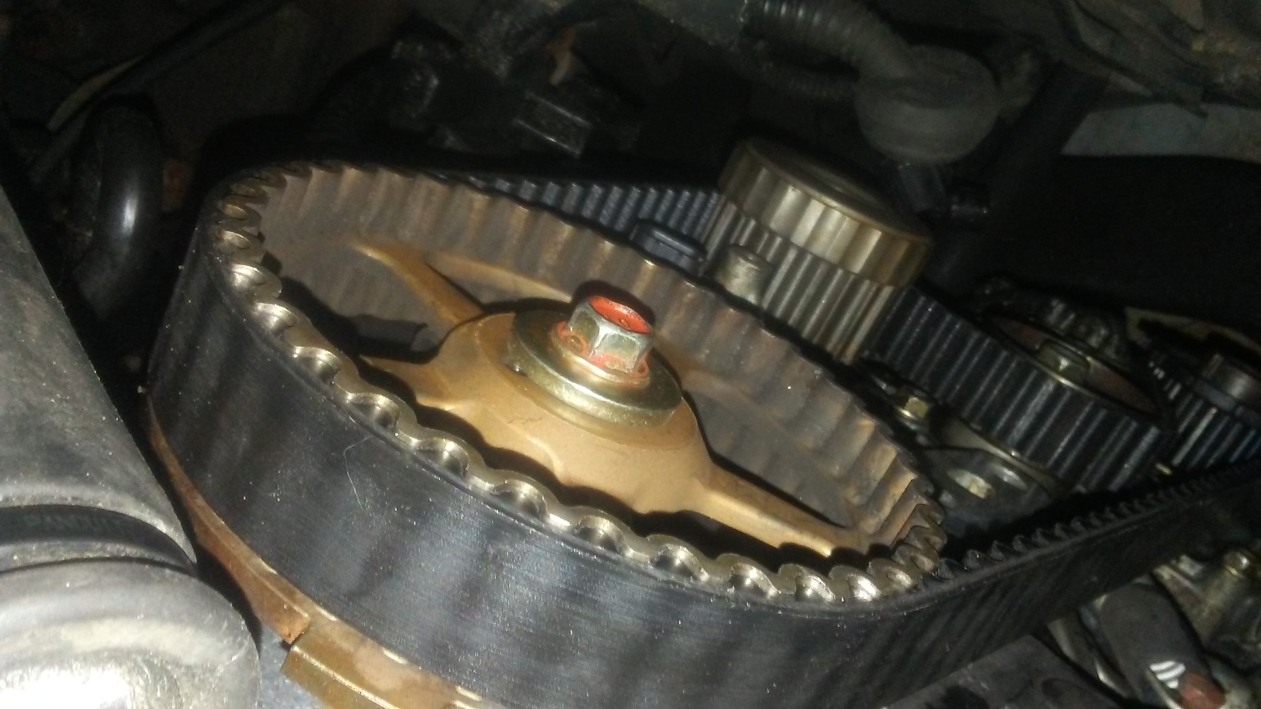

Also would like to check the cam seal,
would that require me taking that top pulley off right? I guess I
have to secure it from moving also to loosen that nut...
ever remove that? picture is the one I'm talking about
Name:	cam pulley.jpg
You can look for oil evidence.
I'd break the bolt loose before removing the timing belt.
To loosen or tighten the bolt, I also might use a spanner wrench to hold the pulley by its spokes, or stick a screwdriver under a spoke and onto the head surface if the belt is already off. (you better know what you are doing first, move the cam too far and you can bend valves)
Get specs. Use a good torque wrench when tightening that bolt. If it comes loose it can bend valves.
