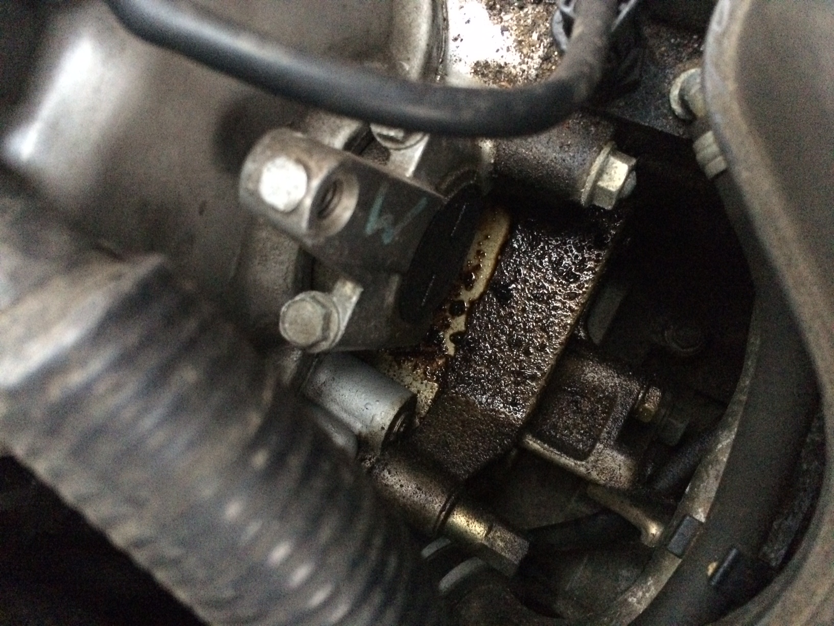

Hi Guys, looking at this pict, I can see a leak on passenger side while standing in front of the engine. It's for 2003 Civic LX with AT.
I can't really tell looking at part list, if there's a seal underneath this black rounded cover or is there's a seal/gasket?. What else could be the reason for oil leak?
Thanks for the help.

So I found this part and there seems to be an o-ring with it:
12513-P72-003
Can I buy the o-ring separately or need to replace the whole part? Thanks

You just buy the whole plug, it comes with the new O ring built in.
The plug is just under $10 (MSRP) and pops in place in about 5 seconds (unless there's an EGR valve in the way, but your pic doesn't show an EGR).
Most of the time, at least one of the lock tabs breaks off of the old one when you pry it out of the head. Check after you get it out, and see if you can fish out the broken piece(s) before shoving the new part in.

Should I put any sealant or bond or anything before I put the new one in?
I am not sure if my car has EGR port, I don't see any and it's an LX.
Old Dec 30, 2016
Re: Is there a seal at this Oil leak?
Some people do, but I do not. I figure the O ring was designed to seal it, and the factory didn't see a need to put goo on it in the first place. Plus, if you goop that on you'll have a hell of a time removing it when it leaks again 100,000 miles from now.
If you had EGR, the valve would prevent easy access to that leaking plug. You'd have posted swear words about rusted nuts and not having tools that will reach them instead of a calmly typed out question LOL
Agreed and makes sense. O-ring should be enough, plus if there be a leak later, I can use bond afterwards.

Just to close this thread, I was able to remove the old one and inserted new(Beck Arnley) plug without any silicone/goop and so far seems like there's no leak.
Old ones O-ring was completely hard/brittle and hence no gasket effect was happening.
Thanks to everyone for their help.
