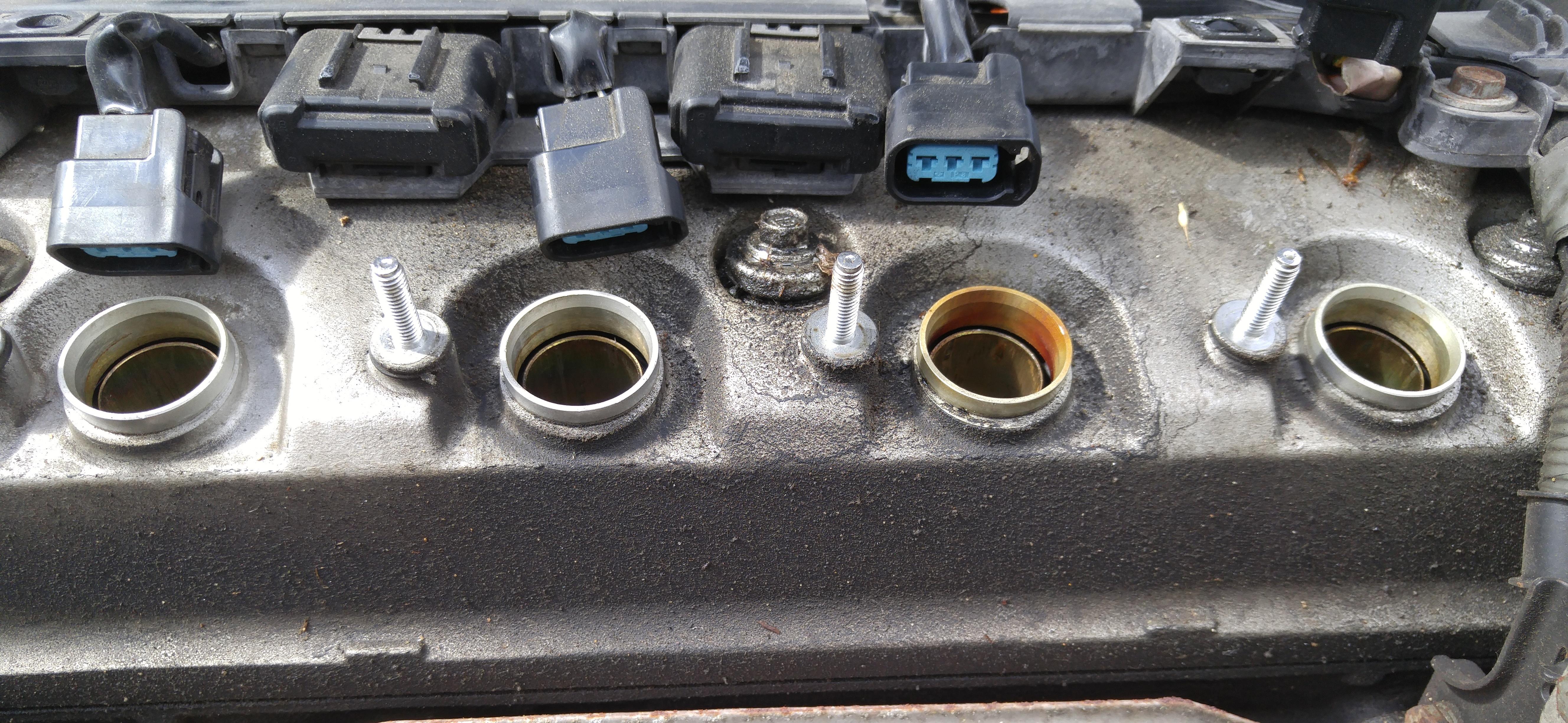

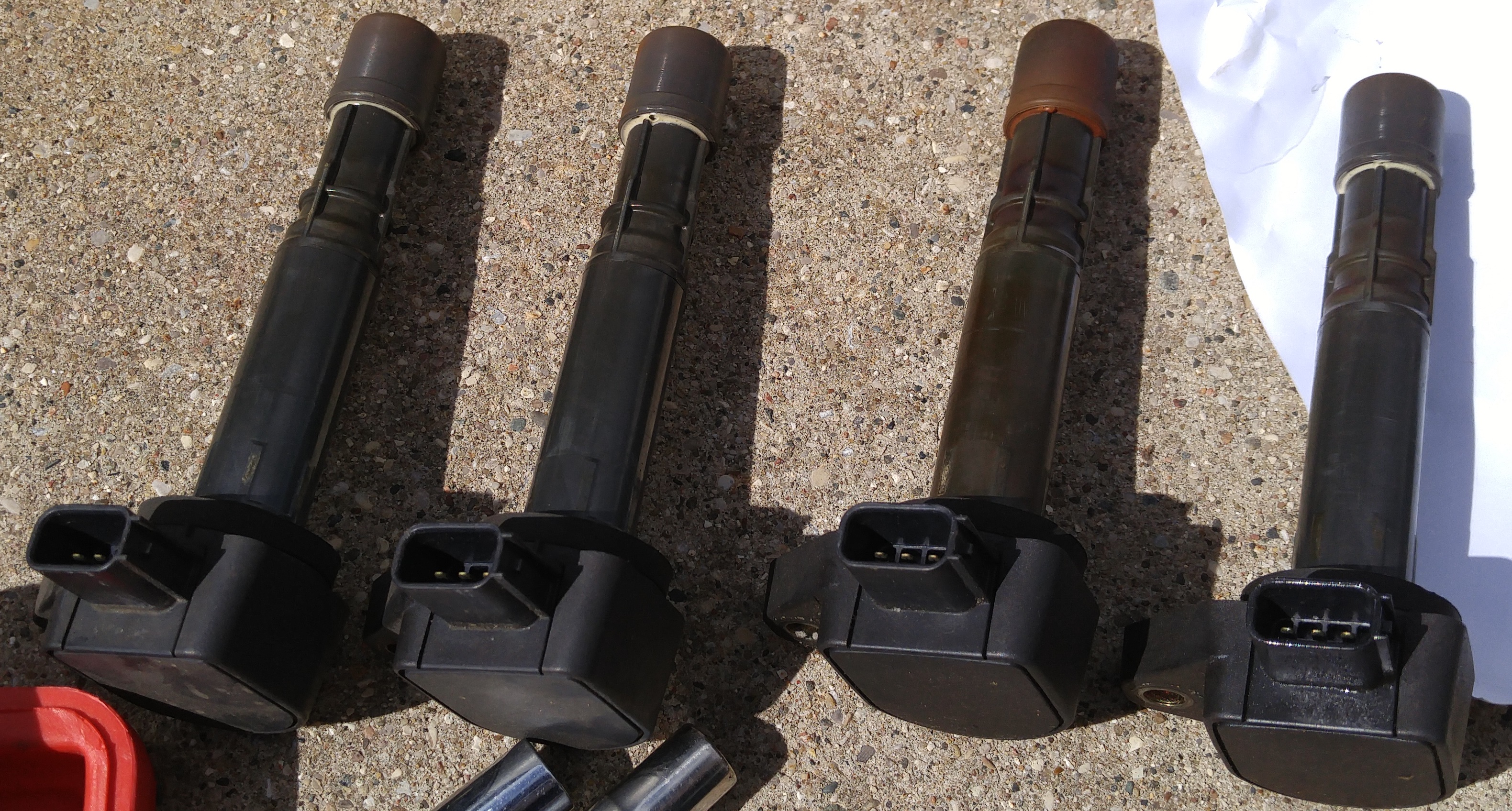

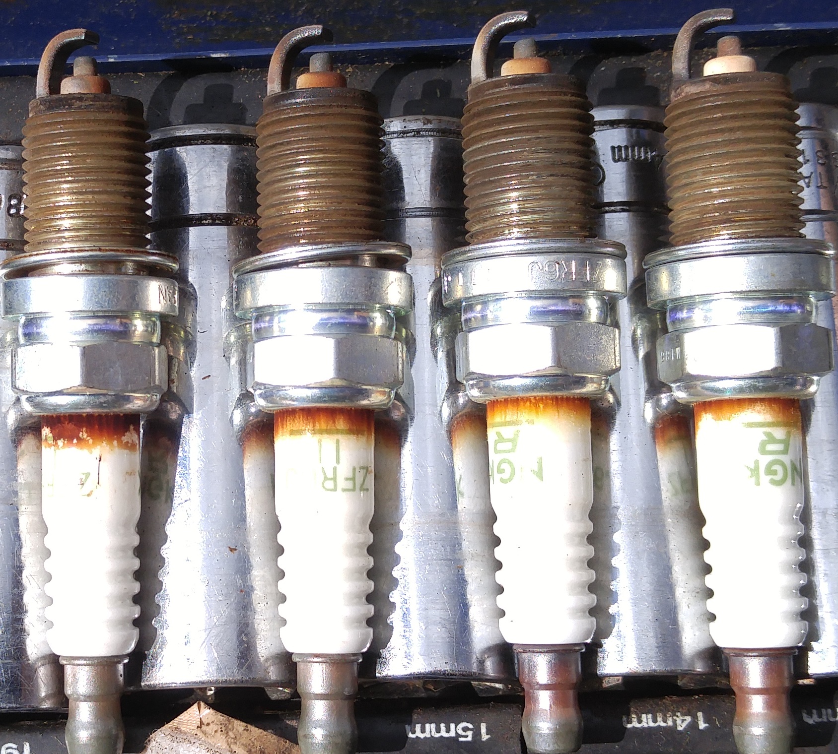

Question 2: the engine I purchased has great compression in all cylinders but the spark plug boot and top of spark plug chamber are both brown compared to the other ones (see picture). The boots and plugs are all shown in the same order for comparison. to my untrained eye the plugs all look fine. Is this a leaking spark plug seal in the brown colored cylinder? There seems to be a bit more dirt/grease on that section of the engine as well.

spark plug or plugs may not have been tightened enough, left too loose,
