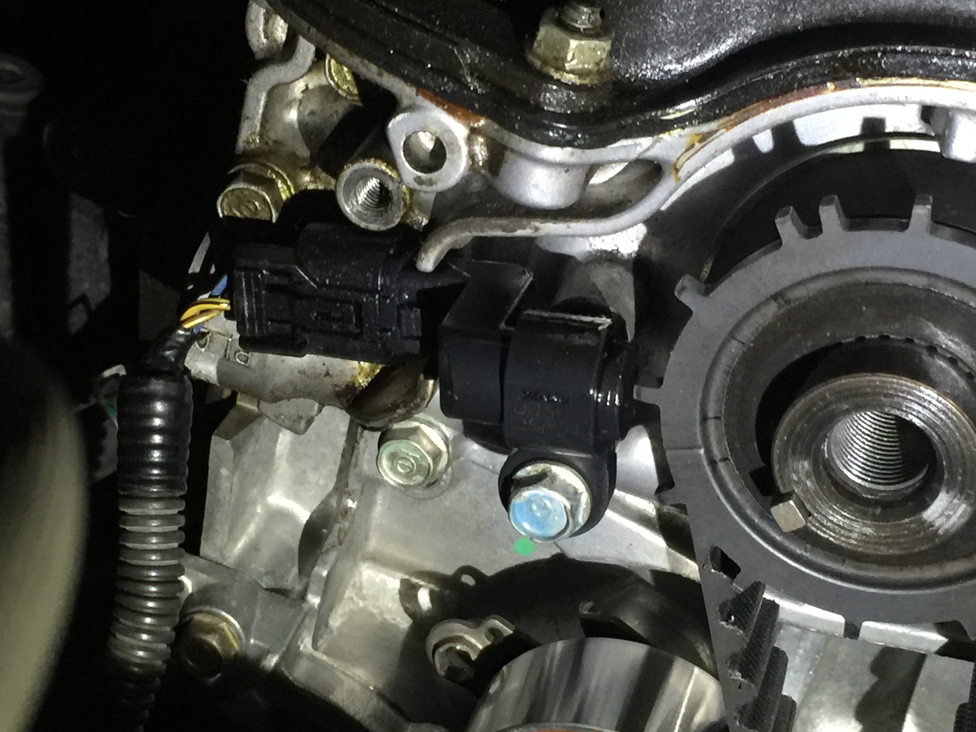

About 3 months ago the P0335 code appeared and I ended up finding that coolant was leaking onto the ckps. Replaced sensor and all was good until now (3 months later) until the same code popped up. I just got to the sensor tonight and am going to include a picture of the area. There is clearly fluid (oil?) kind of all over the area including on the sensor itself. Bad oil pan gasket? I appreciate anyone out there who can help confirm.

Coolant got into the connector?
I'd suspect now there's some corrosion inside the electrical terminals (harness side) causing bad connections.
Can't tell you where the oil leak started, nor if it's got anything to do with the code......but oil will probably make the rubber weather seals inside the wire connector all mushy and not seal well....lets in more water later on.

Thanks, as always, ezone!
Yes, I am thinking that this P0335 problem still resides with leftover coolant all up in the electrical terminals. I'm beginning to see if I can locate a replacement harness.
Now, the oil leak is a separate issue that I'm glad I am finding out about now. I've looked it up on this forum and found that my problem most likely lies with the oil pump o-ring, based on oil residue location. So, I just purchased a set of o-rings for that area in addition to a new oil pan gasket.

Replaced wiring harness for Crankshaft Position Sensor and nothing changed for me. Engine light still on with code P0335. Attempted to clear it and the car wanted to stall. It's still running in limp mode.
I'm wondering if I need to (again) replace the sensor? Very frustrating!

Oh hell, I don't know. You did erase the codes, yes? Now it's reset the same code? How quick does the code reset?
Crank gear is not installed backwards? (IDK if that's even possible)
Start over at the beginning and test as if you didn't know anything about what's already been done?
This sensor on it now, did it get antifreeze trapped in its connector? Could it have corrosion issues in the terminals?
What sort of harness was replaced, just a pigtail and connector?
Possible....Bad connections in the patched new harness/connector? (twist-n-tape isn't a great repair)
Mis-wired, no longer in correct order at the plug?
Poor connections in other connectors on up the harness all the way to the computer?
Terminal tension check on all of the female pins from the sensor all the way to the computer?
Test for power/ground/5v in the sensor connector?
The blue wire goes directly to the PCM.
The other two wires go to the splice packs on top of the valve cover before heading to their final destinations (either ground G101 or main relay #1), so there are several possible spots that could have issues. Might need a wiring diagram to see splice pack breakdowns.
