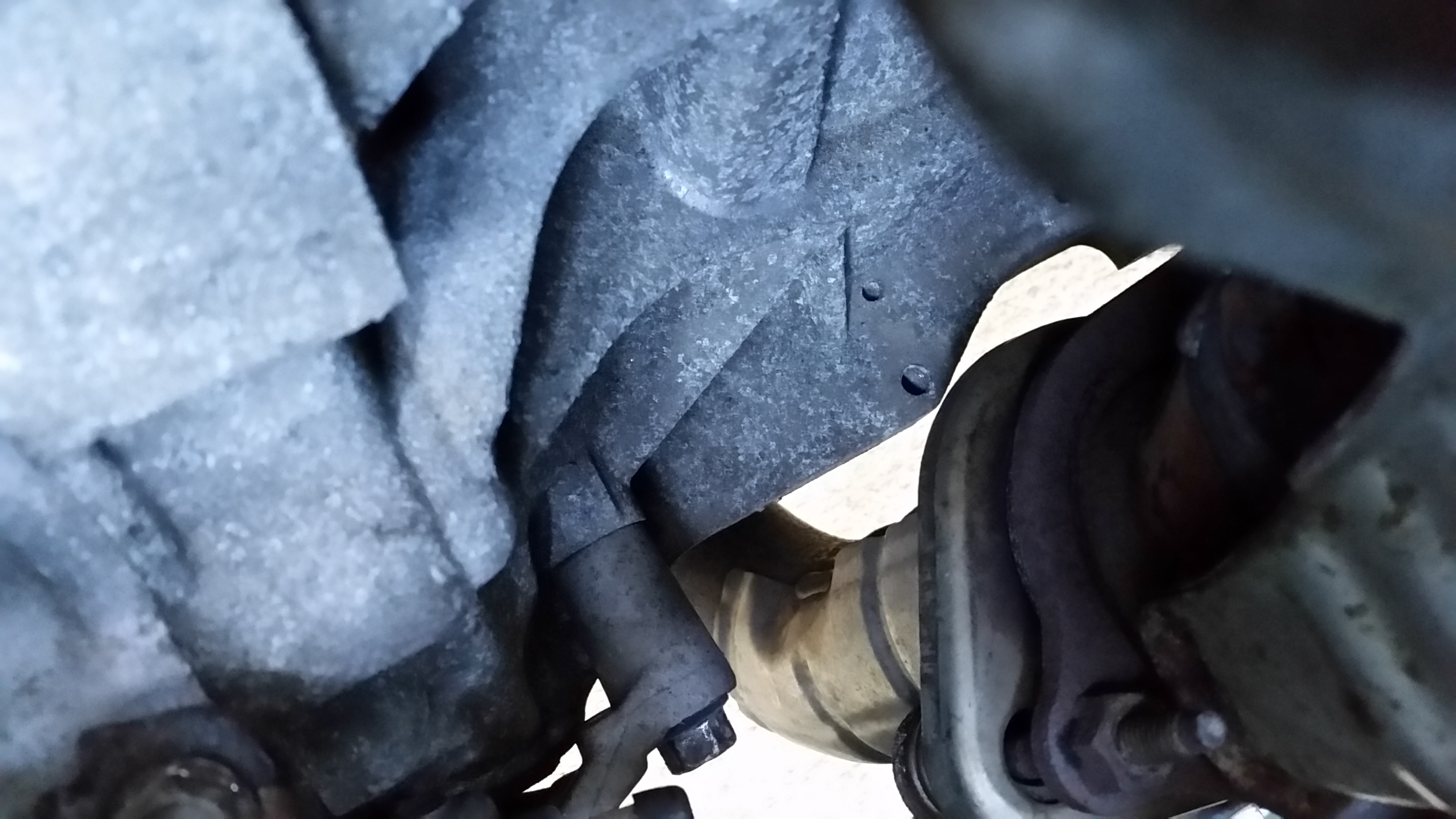

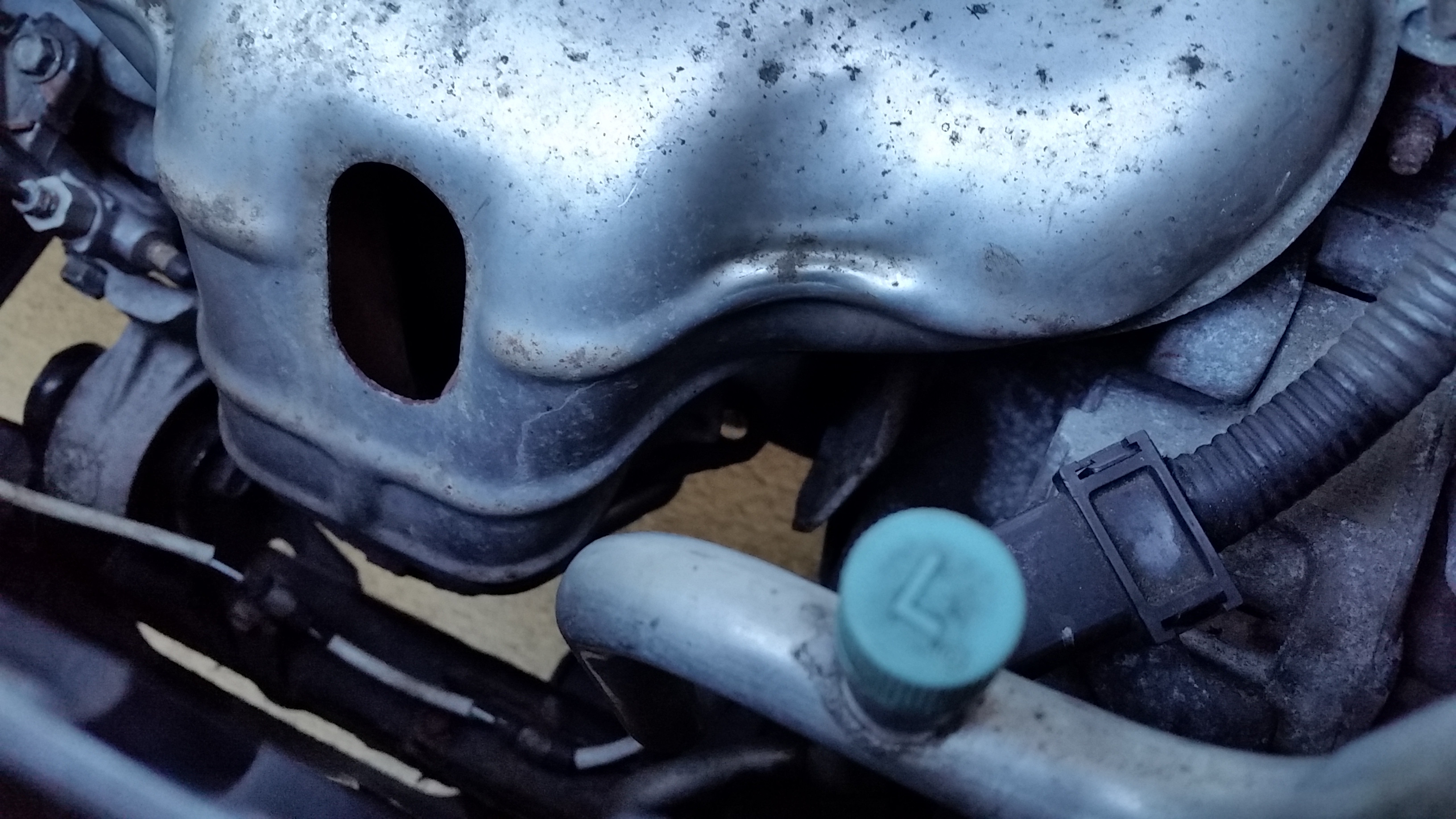

I was checking on my coolant overflow today and noticed the exhaust manifold only had one bolt holding it, is this normal?
The first day I got the car back after the trans overhaul there was burning grease coming from the bolt creating some smoke which has since disappeared.
Old Jul 30, 2016
Re: High coolant pressure 2005 Acura EL
On a phone, cant see pics good.
The top shield should have 2 bolts at the top which go through the manifold into the head
Edit: is that a 1.7 engine or something else?

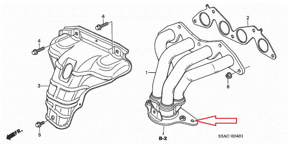

I'm talking about the lower part where it starts to go into the exhaust. My pics aren't the best here is the empty hole I think I'm looking at.
Old Jul 30, 2016
Heat shield is held in with the 3 bolts shown on the left pic.
The open hole you point at might be for a support bracket on the front of the block, if there arent any below
