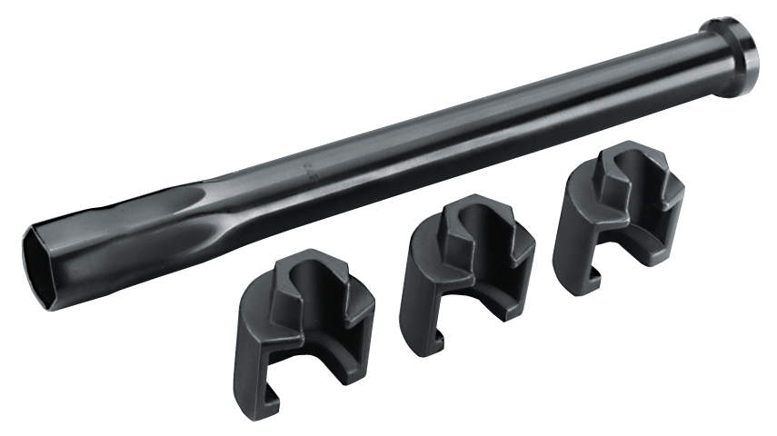

OP... did you try it after removing the outer tie rod first and using a tool like this: https://www.otctools.com/sites/defau...95A_2802_0.jpg
