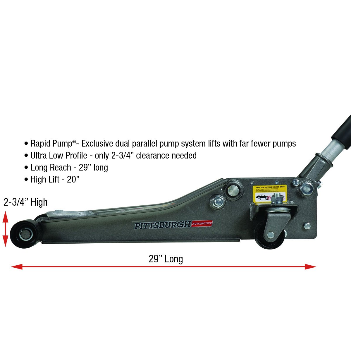

Re: Always cranks, occasionally won't start
Sign of breached head gasket: Are you losing any coolant in the radiator and gaining coolant in the over-flow tank (reservoir)?
I know concern for a blown head gasket isn't what your initial post is about and it's (as you stated) had a recent head gasket replacement, I just thought I'd mention one of the more common signs of head gasket failure for Civics.
For added safety and convenience when working under you car you might want to invest in a large (2 to 3 ton), low profile hydraulic jack similar to this: http://www.grumpysperformance.com/flr68049_1.jpg I use this in conjuction with jackstands as additional support and back-up. Also, invest in some wheel chocks: http://www.harborfreight.com/solid-r...ock-96479.html
Nope, the fluids look fine, nothing mixing, etc. The engine appears to be totally fine after the shop worked on it. At this point, I think it's just a fuel related issue - I can figure out how to measure the fuel pressure (not the easiest thing on this car, have to splice in somewhere), pay to have it diagnosed, or spend that money taking a chance and replacing the fuel pump (I think that's the issue, but not entirely sure).
As for jack stands, I've been using the included thing to raise the car, and then sliding these under to actually support it:
Amazon.com: Torin T42002 2 Ton Jack Stands (Sold in Pairs): Automotive Amazon.com: Torin T42002 2 Ton Jack Stands (Sold in Pairs): Automotive
I forget which version I bought, but knowing me, I probably went overkill and bought the 3 ton one in case I own an SUV in the future (yeah, I know 2560lbs is barely over 1 ton).

As for jack stands, I've been using the included thing to raise the car, and then sliding these under to actually support it: Amazon.com: Torin T42002 2 Ton Jack Stands (Sold in Pairs): Automotive I forget which version I bought, but knowing me, I probably went overkill and bought the 3 ton one in case I own an SUV in the future (yeah, I know 2560lbs is barely over 1 ton).
As always try to diagnose/test first before buying parts. If, you do want to try a part you could pull one from a junkyard and then return it if it doesn't work or help the situation.
Those are good quality stands. Sounds like you're saying that you purchased the combination of items check marked below the stands. If that's the case then well done, Sir.
I prefer the long handle (racing) style jack but, that's because I'm an old man and my jacking skills aren't what they used to be...lol
