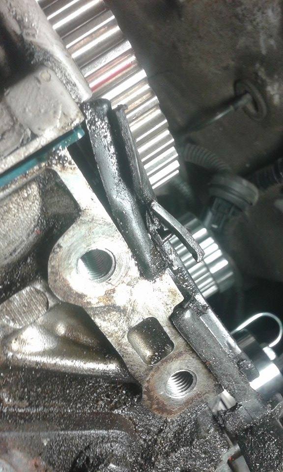

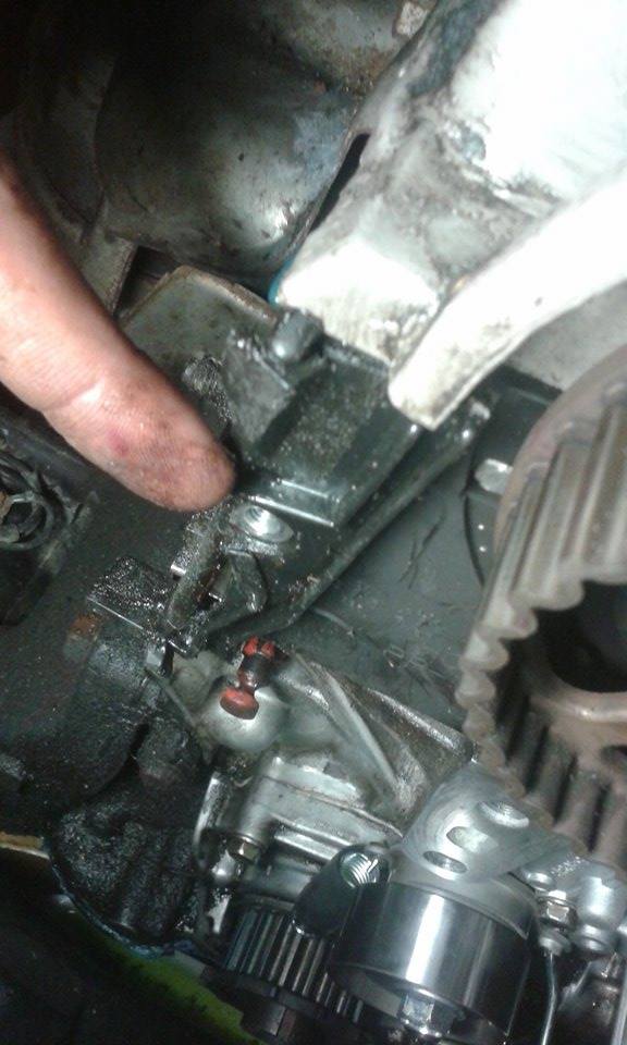

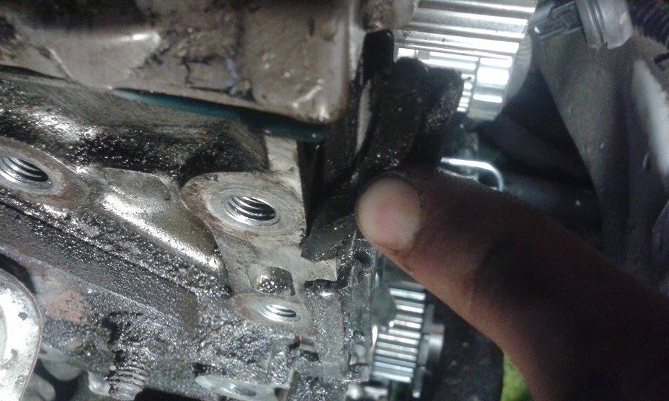

Can anyone look at the attachments and tell me if that might have an effect on anything.
Oil leak covers the entire engine
Between the pics and your statement from the first post......
I see what looks like a blue colored valve cover gasket, meaning it's been replaced at some point...(Fel-Pro gaskets are often blue in color)
Looks in your pics that most of the mess starts about that level.
So the questions:
Is this mess just leftovers and the actual leak was fixed with the new valve cover gasket?
Or is this mess from an active leak at the valve cover gasket?
Have you had that valve cover all the way off and inspected the gasket?
Were the valve cover bolts tight?
It's not all that expensive and you have the valve cover loose for this job, may as well replace it now.
I'd clean the entire area thoroughly and then run it to see where any new leakage begins. I might even coat the areas in white powder (bath talc, Right Guard, etc.) to help show any leakage path after the leaks occur.
