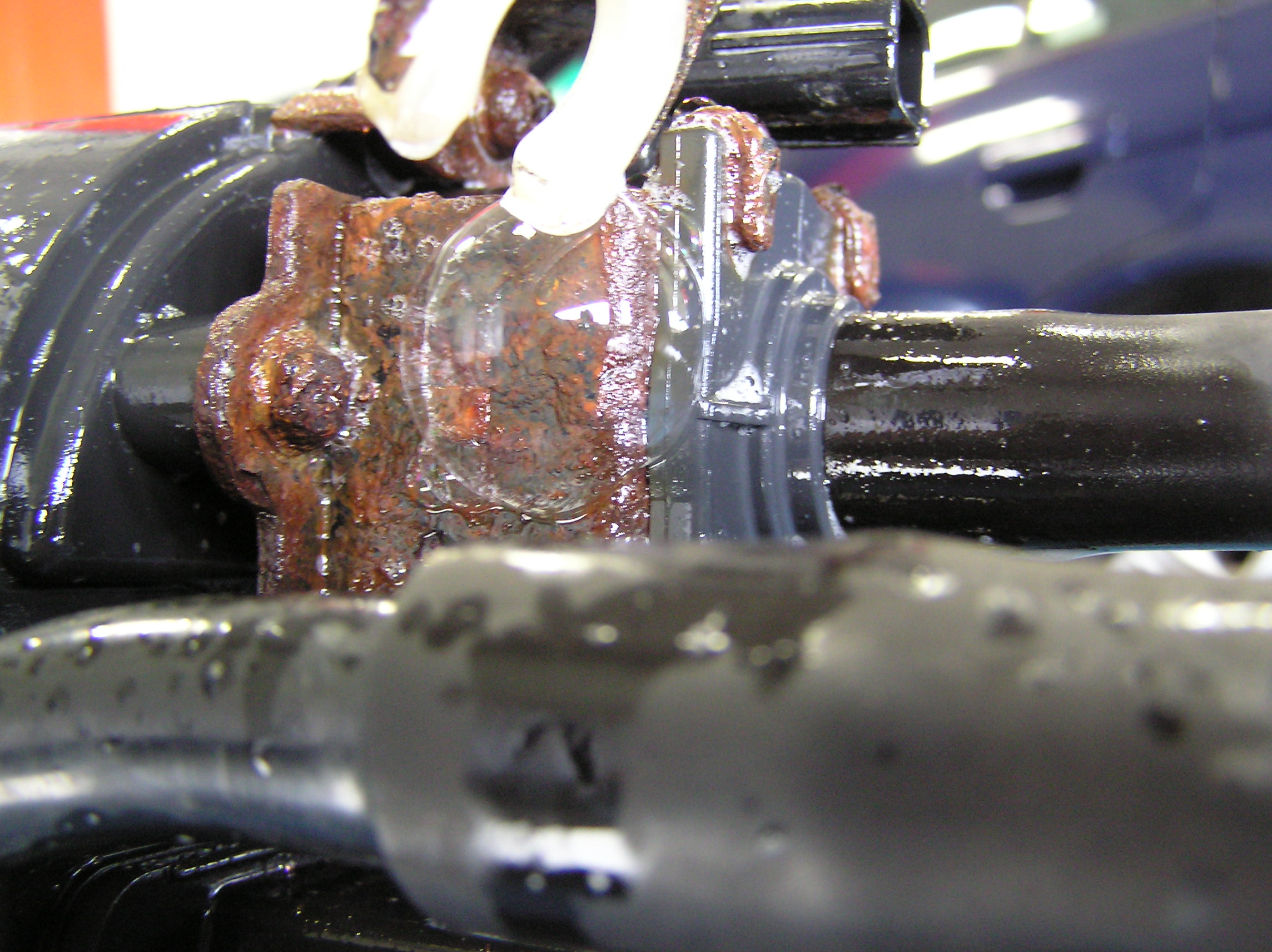

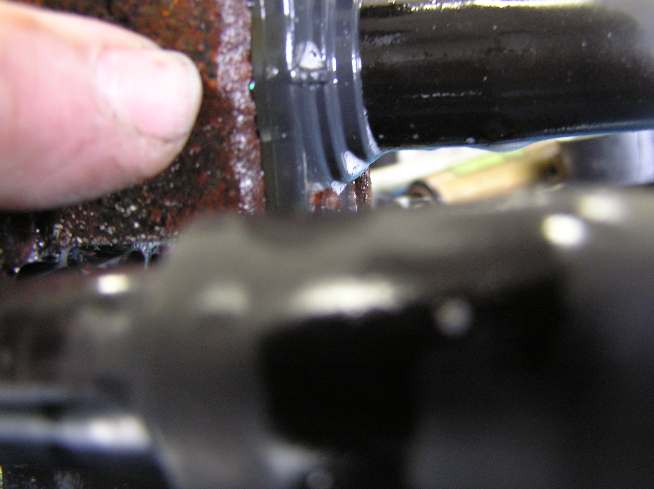

CVS valve is probably the more common failure IMO, I have seen them sticking, leaking, or rusting apart and leaking externally.
Pics of one canister assembly removed from the car, sealed and tested using approximately 1 PSI pressure. CVS valve that was rusted and leaking externally is evidenced by the soap bubbles:
