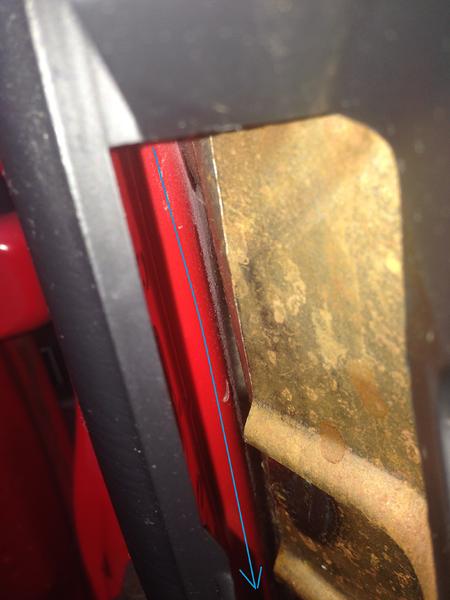

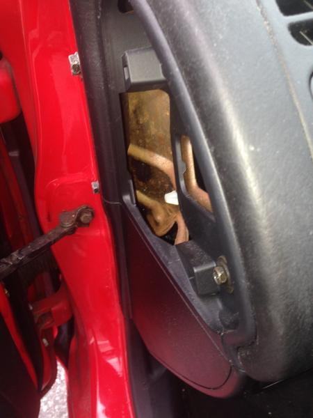

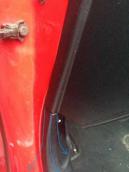

Hello - I discovered after a hard rain that the floor mat underneath the left side of the driver's foot well was wet. Let me first start off as the title says, I have an LX and do not have a sunroof nor have I had my windshield replaced. I know I didn't leave my window open either because it rained again and more water was found trickling down. Lucky for me, it rained soon enough that I could trace the water upwards but had to stop at a certain point b/c the dash is in the way. I have attached some photos showing the issue, with annotations where needed.
Pic 1 - wet floor mat
Pic 2 - where i saw water pooled and running down
Pic 3 - where i saw the water trickling out from
Pic 4 - side dash panel removed to trace water
Pic 5 - found water coming from above this, droplets running down red metal frame. i stuck my finger all the way up there and it was wet
Obviously from the surface rust on the dashboard side bracket there has been moisture behind here for quite some time, however I only noticed the floor mat getting wet this weekend. One thing to note - back in 2008 the driver's side quarter panel was replaced due to an accident.
I did search for this issue but was unable to find anyone with a leak that originates this high up - the leaks threads I saw dealt with the sunroof, front drain line, hood release cable, etc.
Any help would be GREATLY appreciated!

Old Mar 15, 2015
Re: 2003 Honda Civic LX - Driver's Side Water Leak (with photos)
I'd remove the A pillar trim panel and see if you can find water entry that high.
Inspect door seals thoroughly
Possibly have a helper soak with a garden hose (instead of waiting for rain) while you are inside with flashlight looking for the leak.

Old Mar 15, 2015
It's been so long since I've taken the trim off a 7th gen I can't remember. Pull the rubber seal down then 2 clips hold the trim up. Pull starting at the top.
You know the water is at least coming in at a level above the floor and maybe a level even with the windshield, you need to try to narrow it further now.
Water can enter far away and travel a long way from where you see it finally emerge.
Water entering during a rain is usually easier to find than water that only enters while driving, now you have wind and air and sideways forces pushing water in many directions.
Windshield seal bad (usually urethane type caulking)? Bodywork/fender related work? Hidden damage behind fender area?
Lay on the drivers floor with a bright light, look up under the dash at the firewall and side structures?
Hood release cable grommet not sealing where the cable passes through the interior?
Wiring passes through the firewall?
Amp cable?
