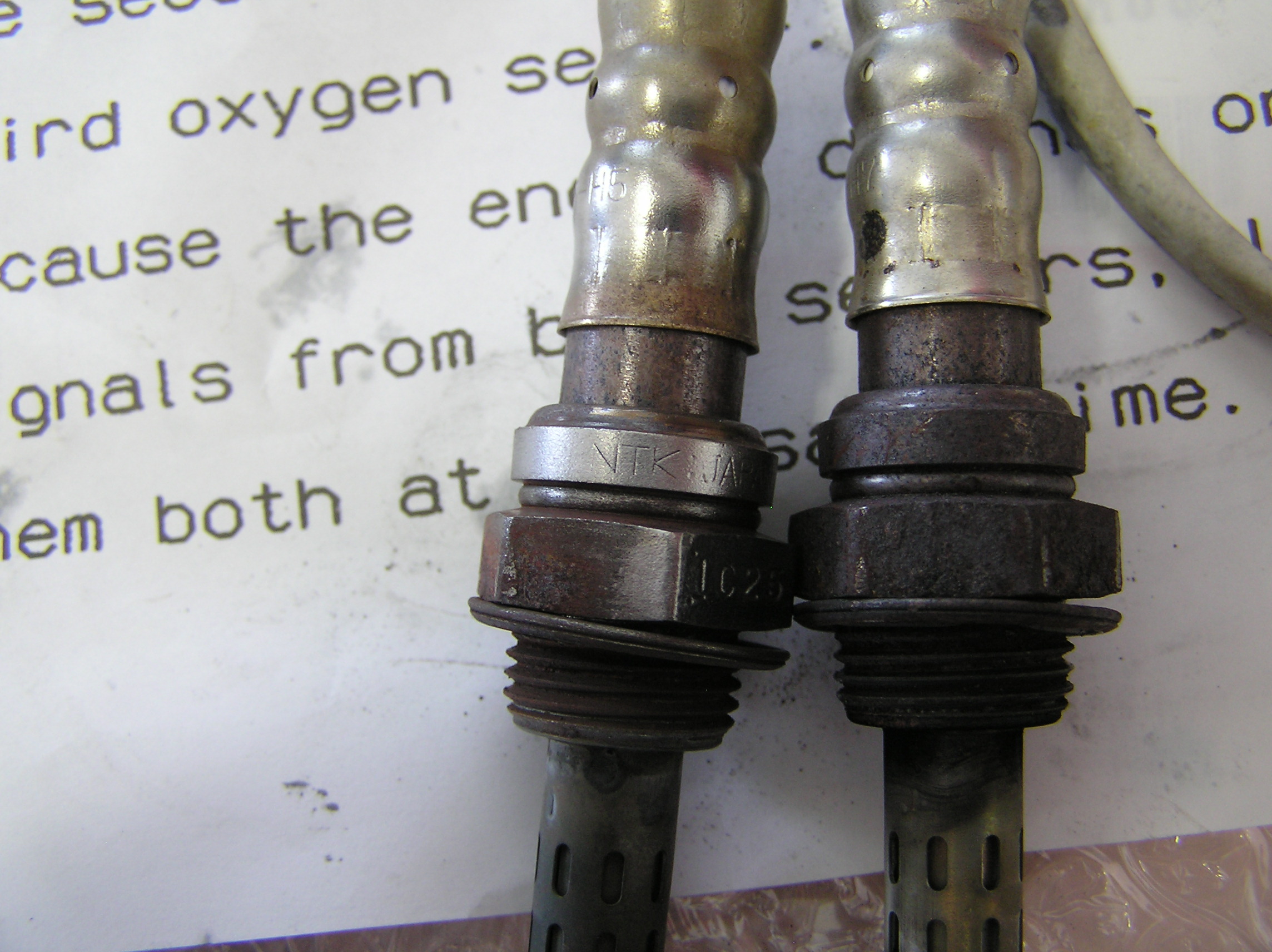

Use the brand the factory used, it will be either NTK or DENSO. Take a look on your original sensor, the name is stamped on it somewhere. You may need to wire brush it to read the name.

Here's some sensors from something entirely different, you can see the name clearly on one after using a wire wheel to clean off the rust:

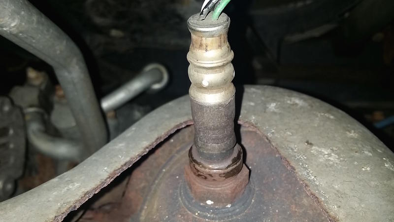

Update:
I just took a picture of the sensor (attached) on my car it's actually Denso! Then what is 36531-PLM-306? Everything besides the sensor (the wire)? This is so confusing .

Old 03-05-2015
Join Date: Dec 2011
Location: Midwest. Aiming about mid-chest
Posts: 32,019
Received 250 Likes on 182 Posts
Rep Power: 493
Re: P0135 O2 Sensor Heater Circuit Malfunction (Bank 1 Sensor 1)
If the A/F Ratio sensor part # 36531-PLM-306 is correct and it's priced around $175 straight from Honda, why would Honda use an NTK or Denso?
NTK and DENSO are both OE suppliers to Honda --- and many other manufacturers.
Honda does not build the sensors, just like Honda does not build fuel pumps, tires, batteries, radios, and many other things they install on their cars.
Same as every other car maker on the planet.
Is the sensor not part of 36531-PLM-306?
I posted the Honda part number directly from the dealer parts catalog.
but I'm trying to understand if that's the only part I need or do I need to purchase the sensor separately?
You should get exactly what you ordered. That part number will (hopefully) net you the correct sensor in a Honda package..
I see Price: $191.12 in your Amazon link. I figured with some research you could get a better price for the same thing.
Majestic $176
A little searching seems to indicate DENSO produced that particular sensor, so I took it a few steps further.
I went to the DENSO website and entered your car information, and obtained the DENSO sensor part number 234-9005.
I googled for DENSO 234-9005, I found many available at local well known parts stores in the $160 price range,
and also found at least one for less than $100 from unknown Amazon suppliers.
Can't tell you about the quality, accuracy, warranty, or service though.
HTH
