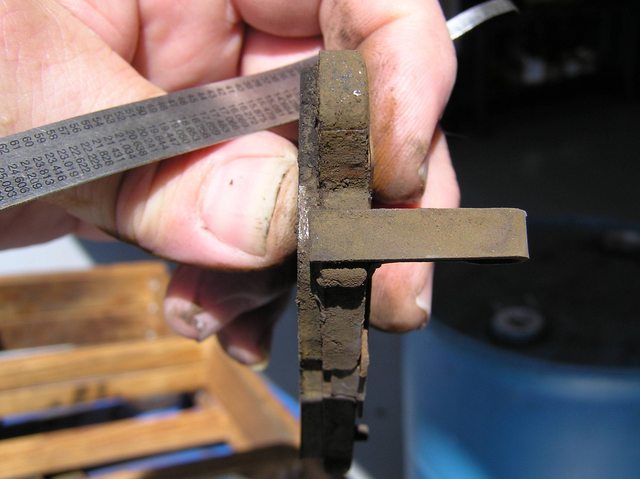

Handy pics? This set got replaced before the squealer made contact, you can see the squealer (metal tab) good in the 2nd pic.
