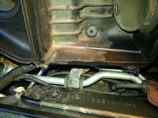

Just following up. I managed to get the cover off and replace the air filter. I ended up cutting the head off the rusted bolt with a dremel and the cover was able to lift. I did not notice before that the two bolts in the back were not connected because the housing snapped. I replaced all the bolts that I could. I left the stem from the cut bolt in the thread. I have 3 bolts around the cover and the one in the center still in place. See attached. Thanks guys.
place.
My only worry would be that since all the bolts are not in place, the filter may not seal as it was intended to, causing air to be drawn in from around the filter, effectively bypassing it. Probably still a good idea to get a new filter housing. Its really easy to replace too...

can you zip tie the lid down? I don't remember what it looks like
