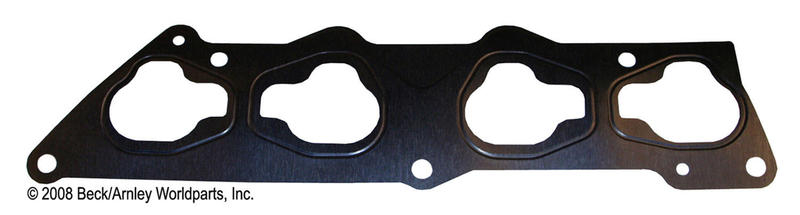

This is what the gasket I took out looked like

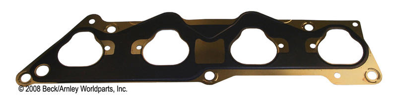

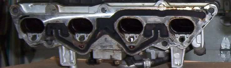

This is what the two gaskets that came in my gasket set looked like
ID:	87138 Click image for larger version

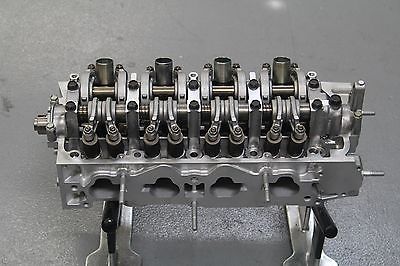

This is what the ports on my intake look like

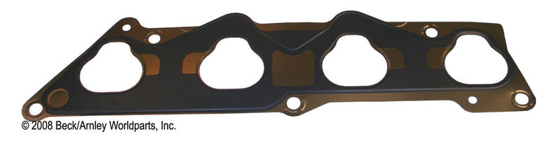

This is what the ports on my head look like
Ok so from what i kind of understand here is the black/silver gasket without the holes is meant for a civic without EGR? my civic doesn't seem to have EGR and all the EGR passageways were very clean. I didn't know which gasket to use since none of the two in my kit were exactly the same as the one I took out. I went ahead and used the black/silver gasket with the extra holes and the car is working but I am hearing air hissing where the intake bolts to the head.
I guess what im wondering is, is it ok for me to use the gasket with EGR holes even though I don't have EGR? or is this maybe the reason I got the air leak? Also whats the black gasket for?? maybe I should have used it instead? its so confusing i've never seen an intake with like 3 or 4 different gaskets for the same year its crazy confusing

Not sure how I missed this post, but I think it's ok to use the one with all the extra holes even without an EGR valve.
