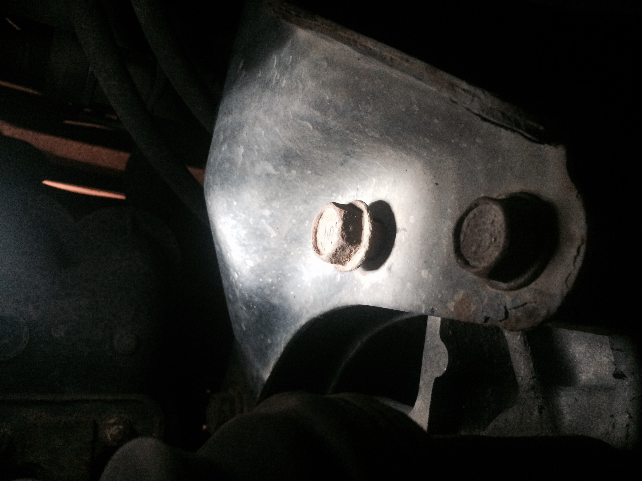

I put the car on jack stands and crawled under to get a good look at the rear mount. The rubber looked fine, but then I saw this.
One of the bolts on the rear mount was not fully threaded in. I was very happy to see this as I was sure this was the cause. I tightened the bolt, checked the other to ensure they were tight, and took the car for a test drive.
The vibration seems less, I think... but definitely still there. damn.
