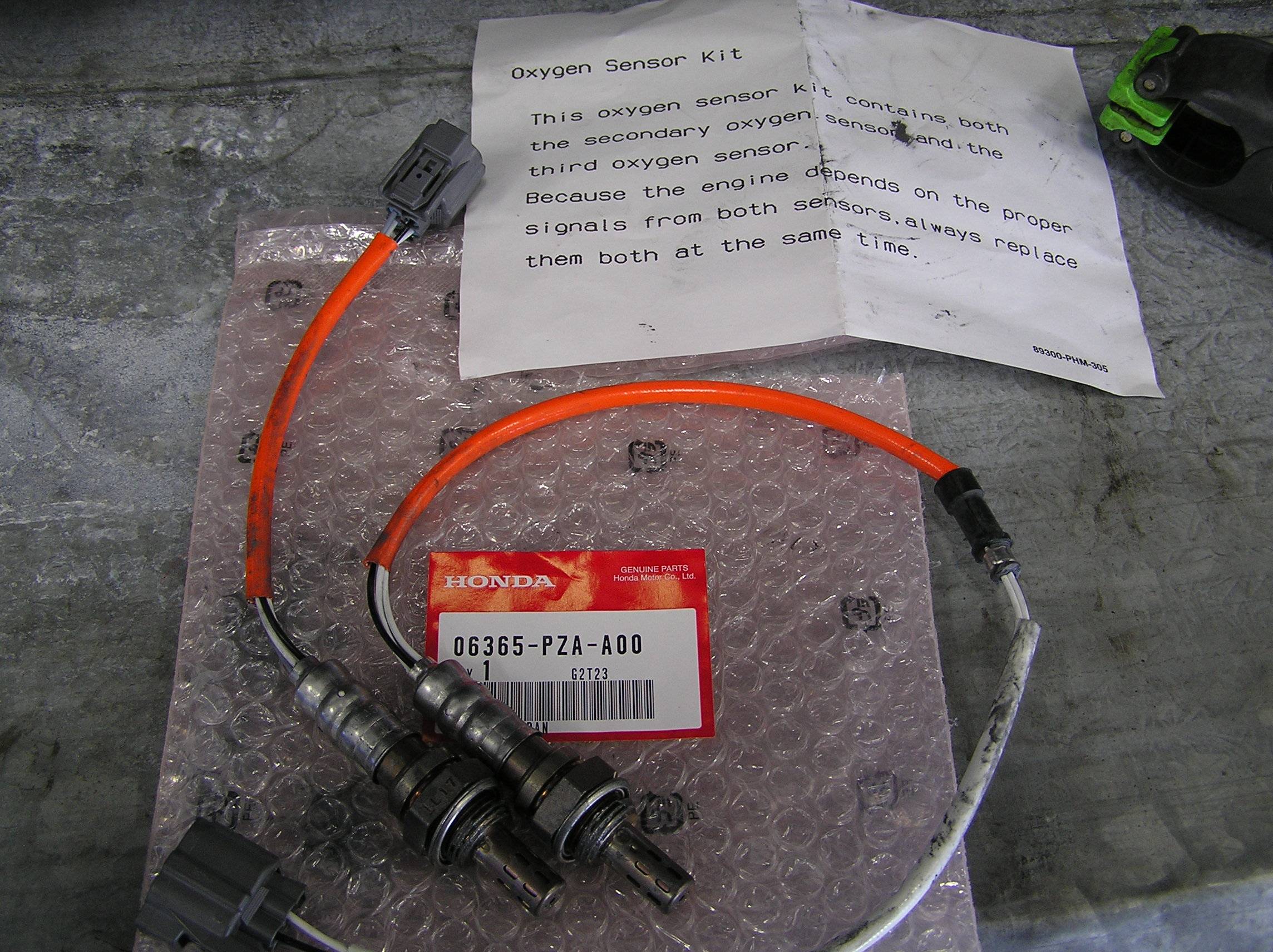

I have pics from one of these cars that use the dual rear sensors (but I believe these were for a hybrid) including the note that was in the package:

ALSO, the cat code COULD have been related to some fault with the dual rear sensors, because the computer uses these sensors to judge the rear (NOX) cat. So I'd probably go with sensors first, then software, and cat replacement last if it still sets the code again.

Your EX price was for a single sensor. The EX, LX and DX Civics use a total of two sensors each.
O2 sensors are generally less expensive than the A/F ratio sensors (also generally referred to as O2 sensors for simplicity). Depending on the model, year, emissions specs (LEV/ULEV/SULEV etc.), there can be different combinations and variations of sensors.
The HX (and some of Hondas hybrids) use multiple cats, the LX and EX use only one cat.
The computer uses the multiple O2 sensors to monitor the performance of the cats.
You are using the control unit that is for the HX engine, and it will always look for the 3 sensors and 2 cats in the configuration it was designed with.
The HX needed to have the extra cat because of its "lean burn" mode, this raises NOx emission levels, this is why the HX model needs the extra NOx adsorptive 3-way catalytic converter (to keep the EPA happy) in addition to the first cat. It's not an ordinary cat, and a typical aftermarket replacement probably won't keep the computer happy for very long.
