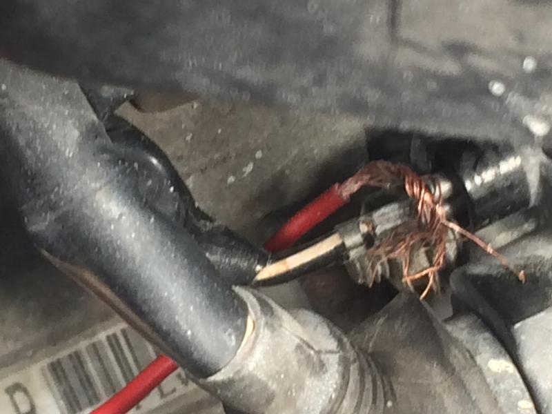

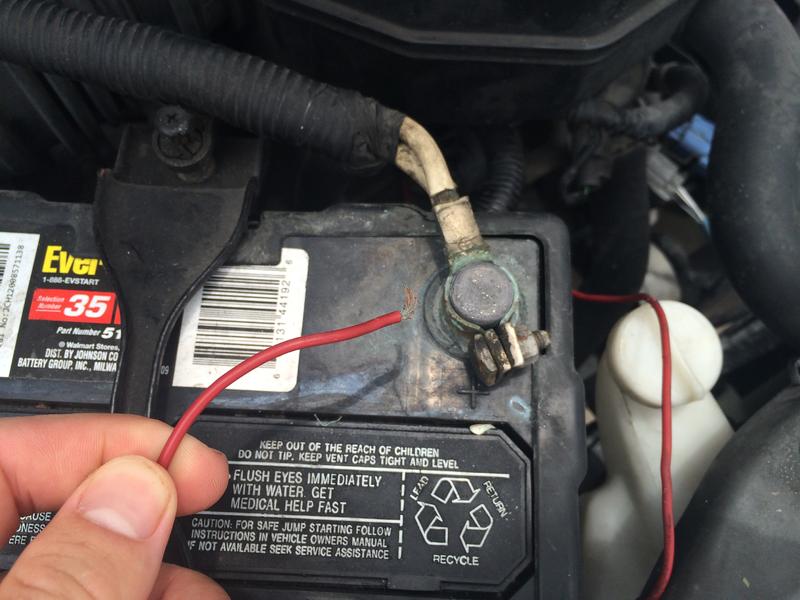

ID:	86812No, that didn't work.
Here are some photos of what's going on.
It won't let me upload the last photo, but it's me holding the wire next to the battery terminal.

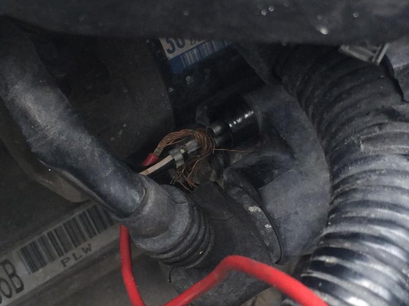

ID:	86813   Click image for larger version

Check all your fuses and make sure that wire isn't touching ANYTHING when you try to start your car.

i think you need to explain a bit better, exactly where is this wire going to and from? is it connected all the time? or are you connecting it to start the car? when the car DOES START, are you using the key inside to start it?
you need to provide alot more information, we cant see anything from here

I'll post up more pics as soon as I can. This wire is connected to the starter I believe. I first turn the car on, so there is power, and then I open the hood, and take the wire, and touch it the the negative side of my battery terminal. I never disconnect it from the starter. The pics show that. When I touch the wire to the terminal the engine starts.
I can't start the car using only the keys. The keys just turn the power on in the car.
The red wire in the previous pics is the wire that I use to start my car with.

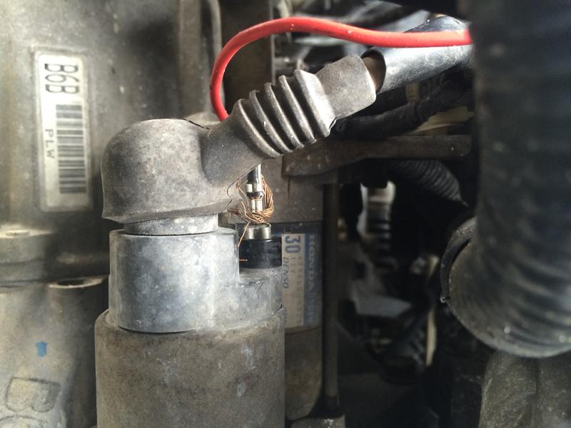

It's a 2004 honda civic lx. 5 speed. Well the ignition went bad and I couldn't turn my key to start my car. I was referred to him by my local autozone store. He hotwired the car so I could get it off the parking lot where it was stuck at and get it to my house.
Here are some more pics of what going on under the hood
Old Jul 10, 2014

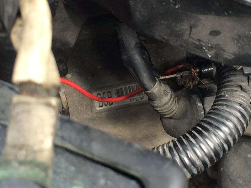

Here is another pic. Sorry I got one more post with another pic. My phone is only letting me upload one photo per post

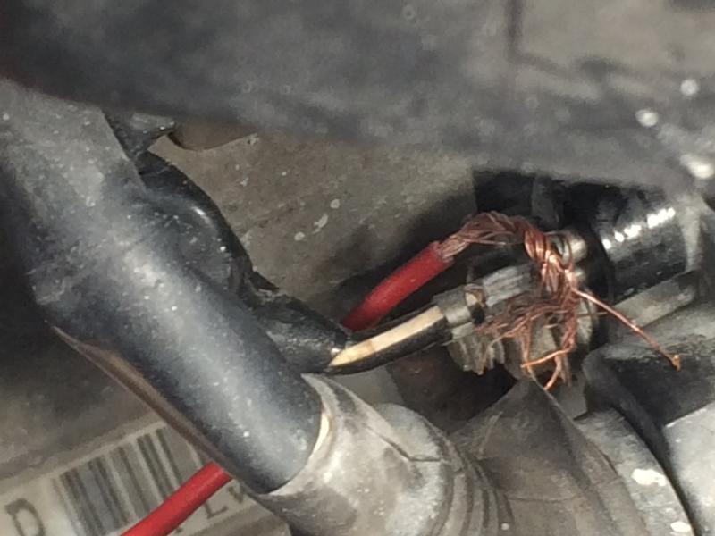

Here is another one

in a previous post you said you touched the wire to the negative battery terminal to start the car, however in the picture it appears you are touching the wire to the positive terminal

Although the OP wants help, based on the ability demonstrated to describe the technical aspects of the problem and temporary solution, I suspect the best help that can be offered is this: Have your car towed to a reputable mechanic or dealership where it can be properly restored to operating condition.
BTW: The battery has two posts, one is negative, the other is positive. The red one with the plastic cover is positive. It may only be 12VDC but there is enough current to kill you. Don't play around with the battery connected... just saying.

Looking at my car again you guys are right. My mistake is brought on by the frustration of being ripped off and the stress of the whole situation. I feel as though this is a learning experience and would like to use it as so and begin the process of learning about my car instead if relying on mechanics fully. I'm going to slow down and take more notice of detail with my vehicle. I would appreciate as much advice as I can get.

lets start with some common sense, the red wire in the picture should not be there, so start by removing it, then we can start the troubleshooting process......properly
