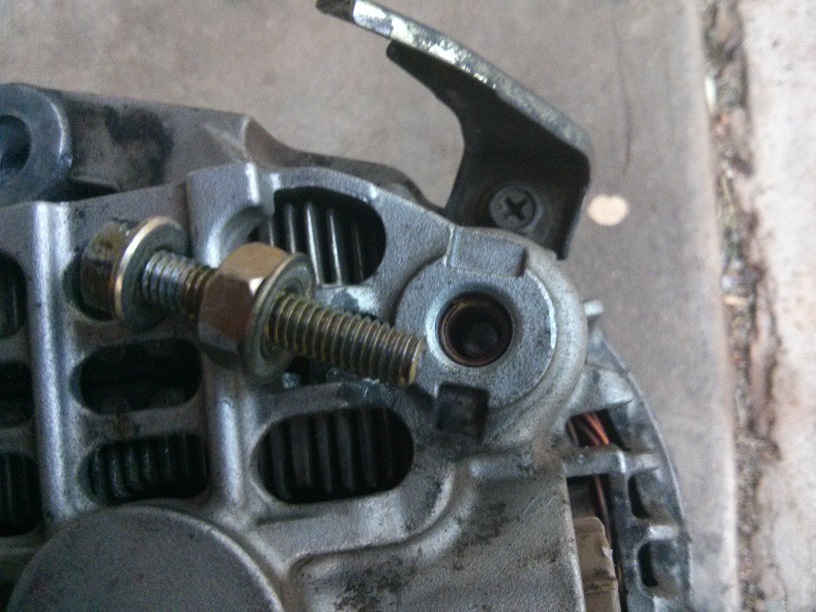

I don't want to keep making threads for every little problem so I'll just put this here. I didn't realize it at the time but the ground bolt on my alternator snapped when I was taking it off. Half of it is still down in the hole and there are no threads for the remaining part to grip onto. I have no idea what to do about this.
A) That would be the HOT cable to the battery positive.
There is no "ground bolt" on the alternator. Ground path is through the cast housing and mounting hardware.
B) You're kinda screwed if that broke off.
Find a local rebuilder and see if they can replace the stud and insulator for you (unless you want to try getting it all apart yourself), or get another alternator.

Bad news is I just destroyed my alternator. Good news is only the rear housing (static) part. The manual doesn't even go into overhauling that side even though it looks like you can buy those parts separately. They are ridiculously expensive though. I think I can find an alternator at pull a part and just use the rear housing from that.
