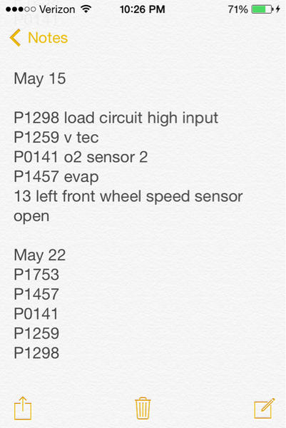

Codes..
Old Jun 3, 2014
Re: 3500 rev limit
Originally Posted by Zaridar
Yes v tec code is on but I disconnected the solenoid and same issue...
Well duh, it's gonna set codes like that. You have to solve the problem, not disconnect stuff.
P1753: TCC sol valve circuit. This is an electrical problem. Unplugged?
P1298, replace the ELD. There's a bulletin on this.
P1457, EVAP leak, canister system. Need diag.
P0141, rear O2 heater circuit. Probably bad sensor, needs checked.
