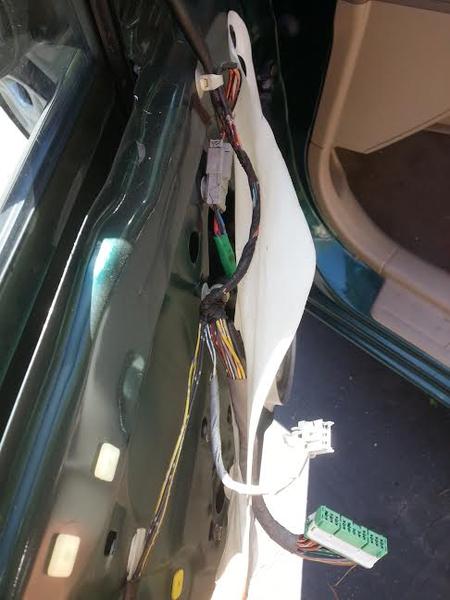

Thank you, mikey1 for the timely response. Here is where I am at. Now this rubber boot. Where should I begin diagnosing?
Please see attached.

Re: 2001 Civic Power Window problem
remove that white plastic crap for easier access,
next you need to disconnect ALL of the wires that go through that rubber boot, to get some slack in the wires
next remove the rubber boot itself, you might be able to just pull it loose with your hands, or pry it out with a flat head screwdriver, it might be easier to get access while sitting in the drivers seat,
when you have the boot free from the frame and the door, you can start pulling all those wires through the boot to get you more slack

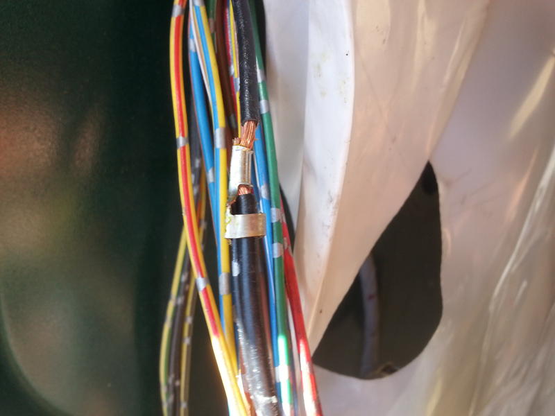

Okay. Does this look at all out of the ordinary to you?
These are wires are right before the Master Switch. I will continue.

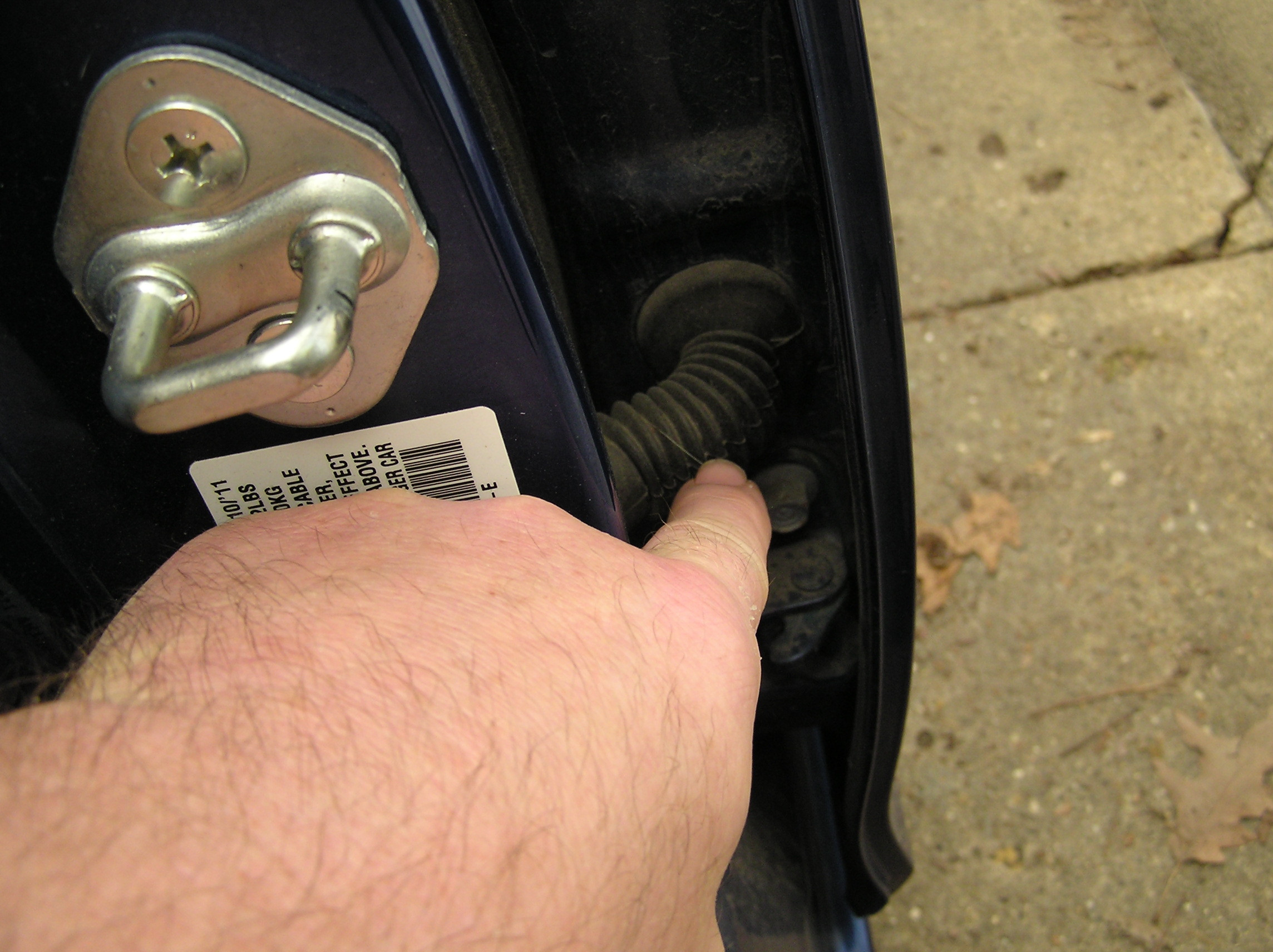

Here's the same jamb harness on my own car
(DIAL UP WARNING! BIG PIC!)
Peel the rubber boot back to expose the wires inside
