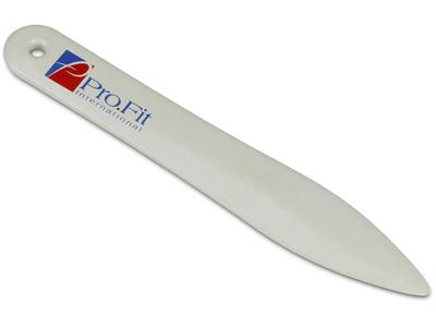

ezone, are you talking about a tool like this?
Yes, something like that made of plastic so it doesn't damage paint or trim.
