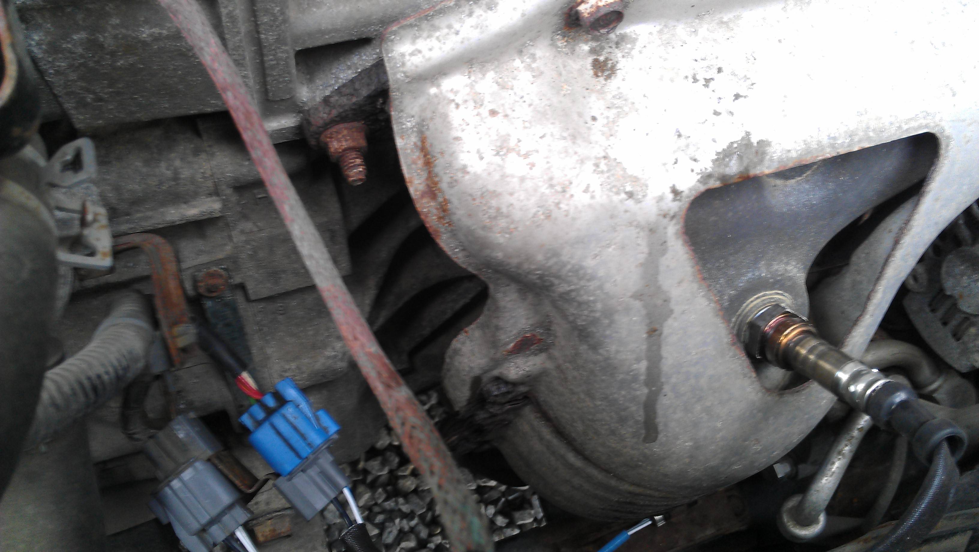

My girlfriend went over to my place to grab some things and I asked her to check the fuses (as advised, thanks again!) and she said they'll all fine.
I told her to start it up and check to hear if there is a very obvious vacuum leak, she says she couldn't hear anything, but did notice exhaust coming from behind the heat shield, she said it was very prominent when the car first starts but fades away as it runs, but it is still visible if you look for it.
Is this something to do with the outside temperature? Its about -2 C during the day.
Or could this be the leak thats causing all my errors.
Sorry abou the photo she says she tried to get a shot of the exhaust.

So I caved and called my brother over to my place to look at my car, giving him a list of things to look over before making a final conclusion, we checked with the volt meter and all the harnesses are fine, everything is working.
I called about 7 different mechanics and they all said the same thing, that you should never put a European component in an asian car. Bosch in a Honda. The sensor that was in the car before was Bosch, but that may be the reason why its been such a handful.
I am pricing out a new Denso sensor now. Any new ideas, please let me know.

I'm not 100% sure if one has to do with other.
You probably have a crack in the exhaust manifold, which is common in these cars as they age. Plus you obviously live in a cold climate, so it has seen extremes in thermal cycles. These manifolds are made of cast iron. You'd have to take the heat shield off and do a visual inspection. I'm sure you're going to find a crack somewhere if what you said was true.
The cracked manifold may still effect emissions slightly, but I'm sticking to my guns that I'd recommend you still replace whatever sensor/sensors you replaced with an OEM one. Now that you've discovered this issue with the manifold, I'd recommend you either fix this one via a weld(really cheap way) or look on ebay or in a junkyard. If you're going to any work yourself I'd be really careful about removing those bolts from the studs. I can see there's a lot of rust there. I'd use plenty of PB blaster or something to soak those threads and bolt before removing it. If you don't, you take the chance of breaking the stud off at the head, which will cause even more headaches for you.
Very common. They crack due to stress and thermal cycling, and after they crack the crack is larger when cold. As the manifold heats up, it expands and the crack closes......thus, the sound abates.
Also, I see them warp and pull away from the head surface, loose or broken studs, etc., without cracking the manifold itself.
You'd have to pull the heat shield off and start looking if you really want to find the cause.
Seriously doubt it. It's an issue, but not the cause of your codes IMO.
THANKS
I SEE the wrong front sensor in there.
*shudder*
Even better, both sensors look like they are very recent replacements. Both Bosch?
Thank you for clearing that up
Seriously doubt it. It's an issue, but not the cause of your codes IMO.I SEE the wrong front sensor in there.
*shudder*
