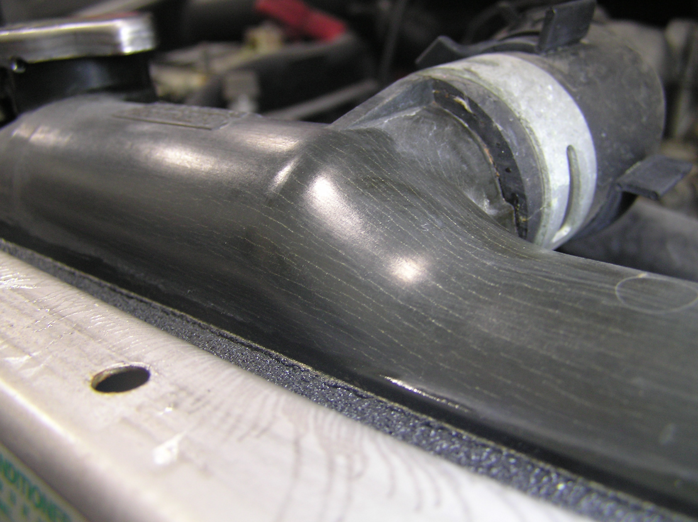

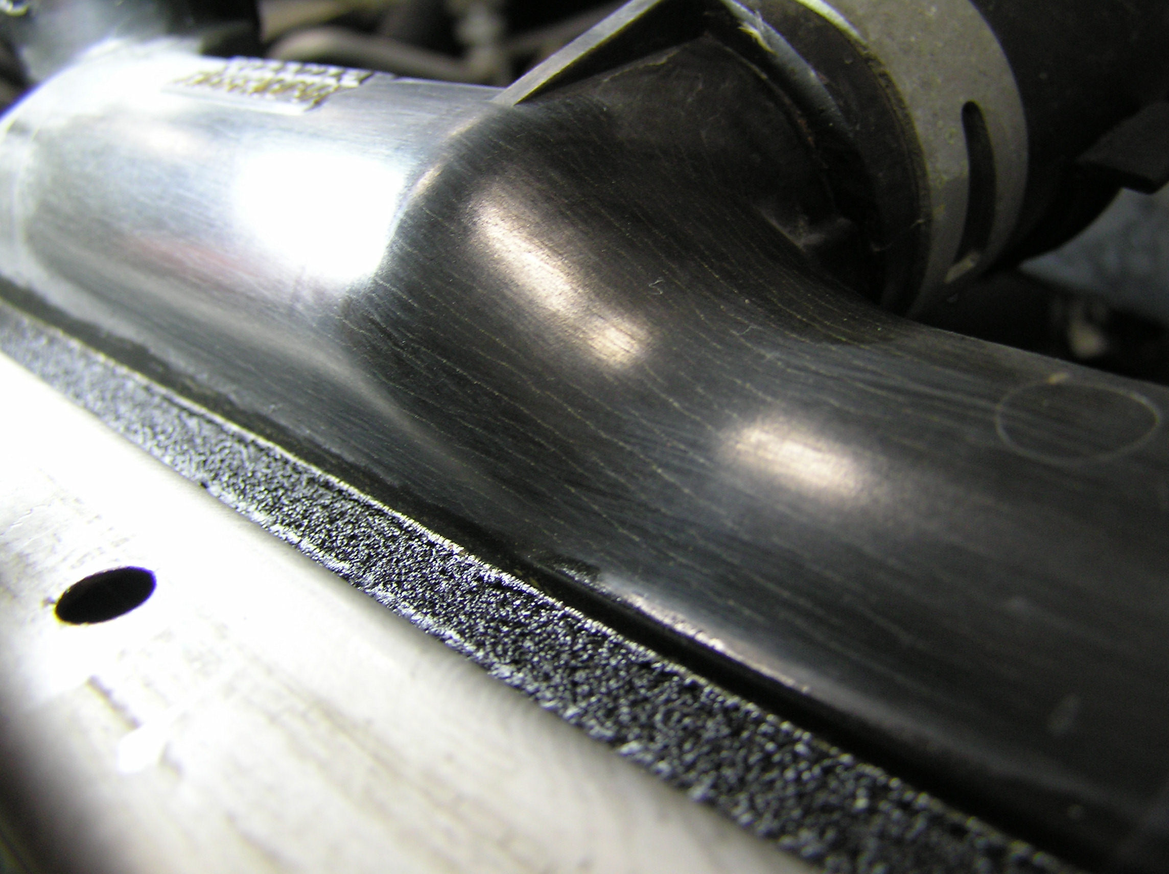

Hey, speaking of radiators......
I took pics of this one that I thought looked really bad. Turns out I was right, it lasted ONE MORE DAY! (Next afternoon, they called and said to order the radiator, it blew up.)
This was on a 96 Odyssey that a kid drives, his father was a customer of mine back in my Mazda days.
I figured a pic is worth many words......

Those are stress lines in the nylon tank. The blowout happened in front of the top hose, below the level of the foam pad. (It had not blown out yet here, the dampness was from trying to clean it for a better pic.)

Damn! Those are some serious stress lines. Is that from normal wear and tear?
Yes.
Thermal cycling eventually weakens the nylon.
There was no obvious indication that it has ever been overheated.
It was just weird that I was able to catch one right on like the very last day of its life (AND take a pic of it) and called it right on the work order, "Hey, uh, I know you only came in for an oil change, but you need one of these right away! This looks really bad!"
