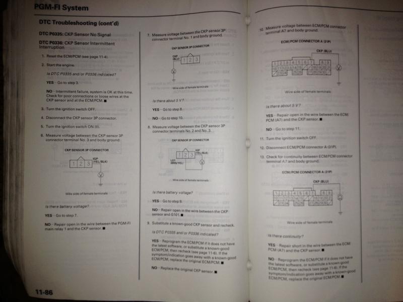

Not sure if you have this but hope it helps. And hope you can read it.

Umm I'm pretty sure that's not happening since that involves changing the entire sub wire harness for the engine bay. Piece #1 below.

battery and alternator are good 14.1v while running. i havent really drove it since i did the head gasket back in may
cant really read the picture kind of blurry on the small print

Hitting [CTRL] and [+] helped me read it better :-)
Basically the troubleshooting JJ291 linked to involves checking the voltage between various points and the sensor itself. Step one involves an ECU relearn procedure.

thanks for the tip on reading that and how do you you go about an ECU relearn? and i just replaced the sensor so i dont really think that is it if i can find out how to do that and it dont work i think im going to redo the timing belt and see if that might be it
