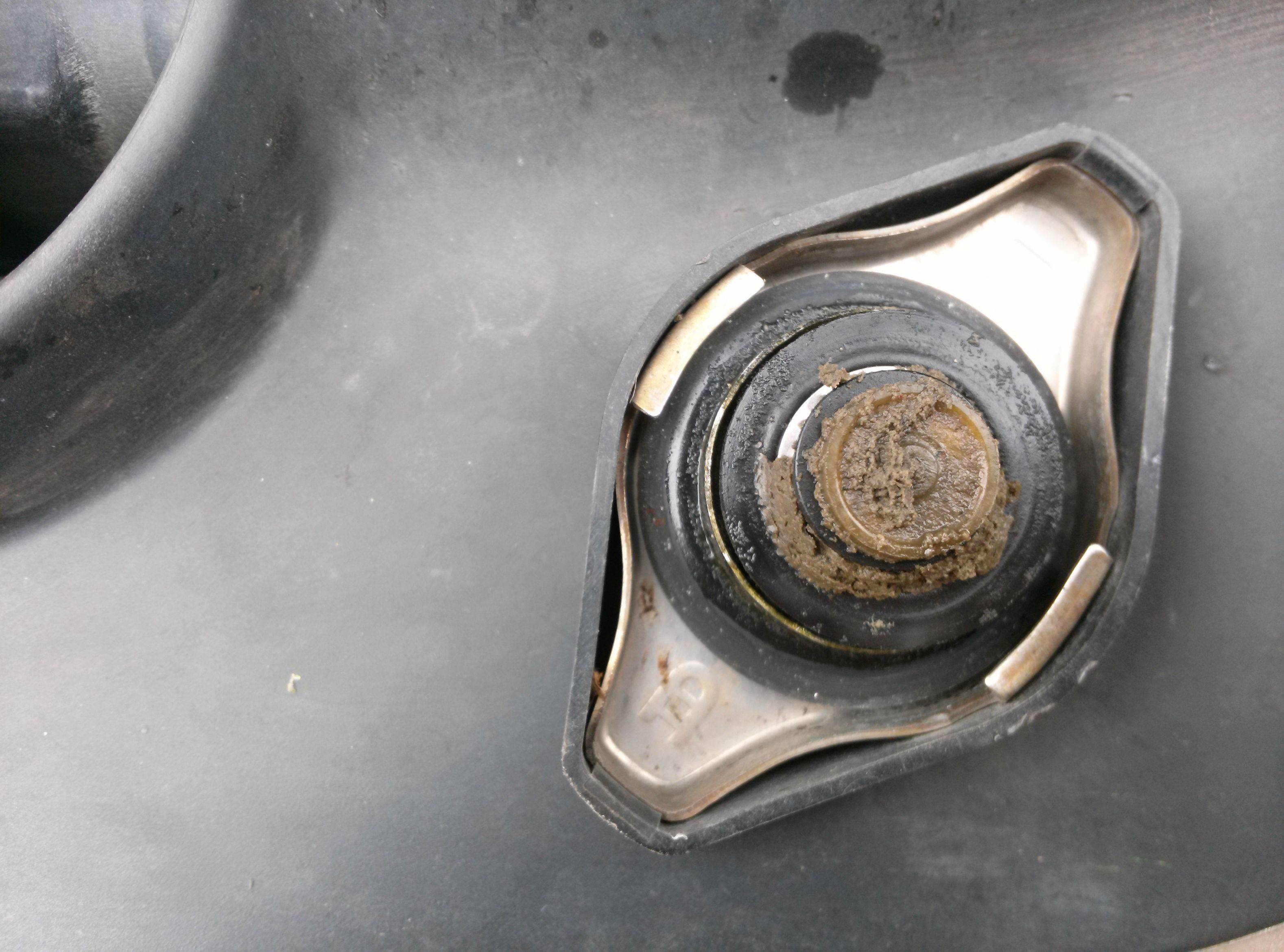

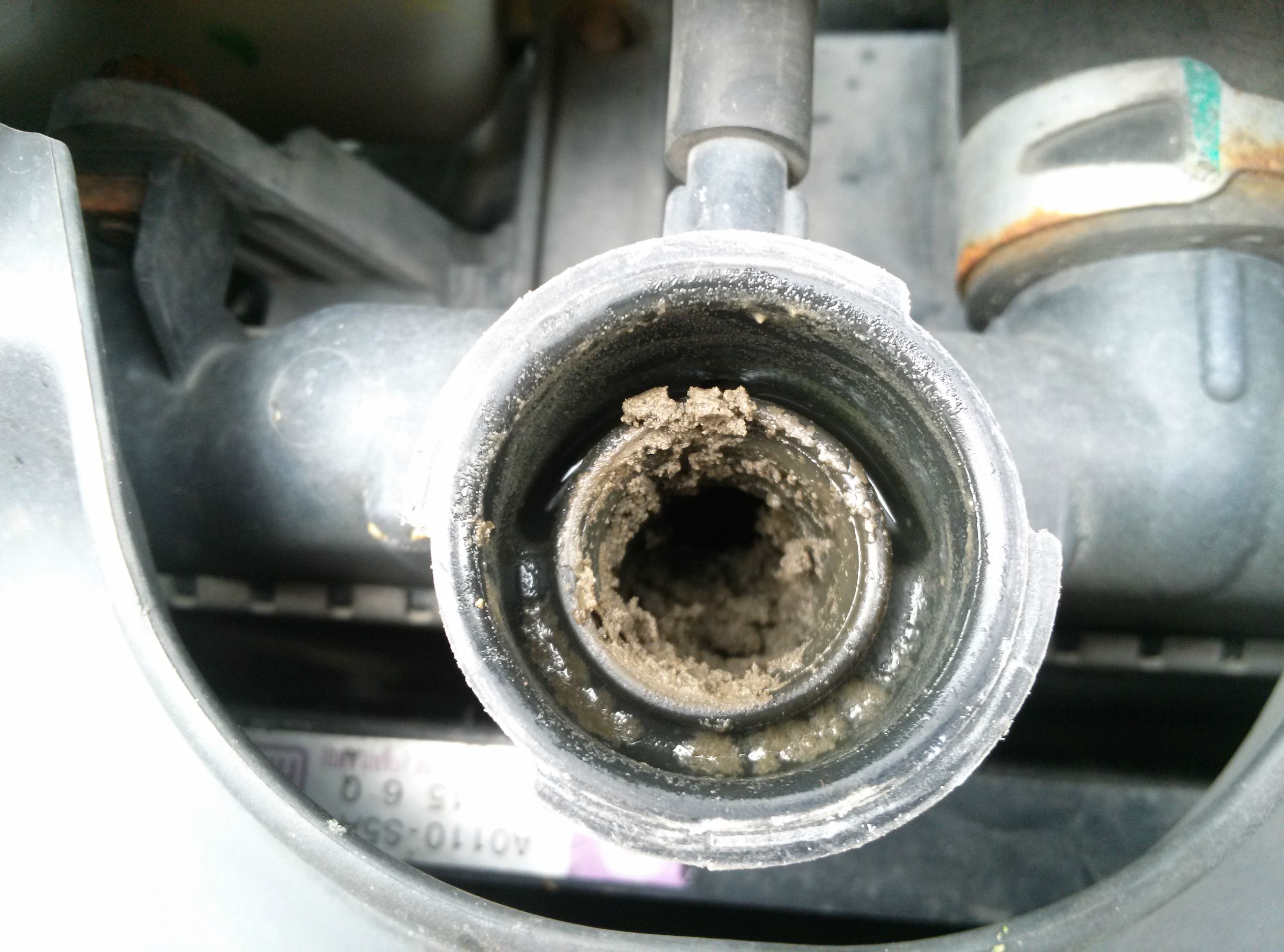

Okay. So I went to check my coolant and it was a bit low. I turned the car on, ran the heat full and put some coolant i had in case of emergencies directly into the rad. it swirled, so im sure the pump is working. it took somewhere around 16oz's. Drove it around for about half an hour and it didn't seem to really over heat. It got just 1 tick above half but nothing major after that. And i also had heat more often than not. When i took the rad cap off i saw this on the cap, and in the spout. It was pasty and somewhat grainy, slightly sticky as well.

That's ugly.
Assuming the engine has had our ordinary normal green or blue coolant in it..
....It's been HOT. That sand-like stuff is antifreeze that has had the water boiled out of it.
You'd get similar looking stuff if you had a GM with Dexcool that has been run low and exposed to air in the radiator. Even without being hot.
But I'm assuming you had normal coolant in yours, so that's very bad.
I'd begin looking for leakage between the cylinders and water jacket. Head gasket blown.

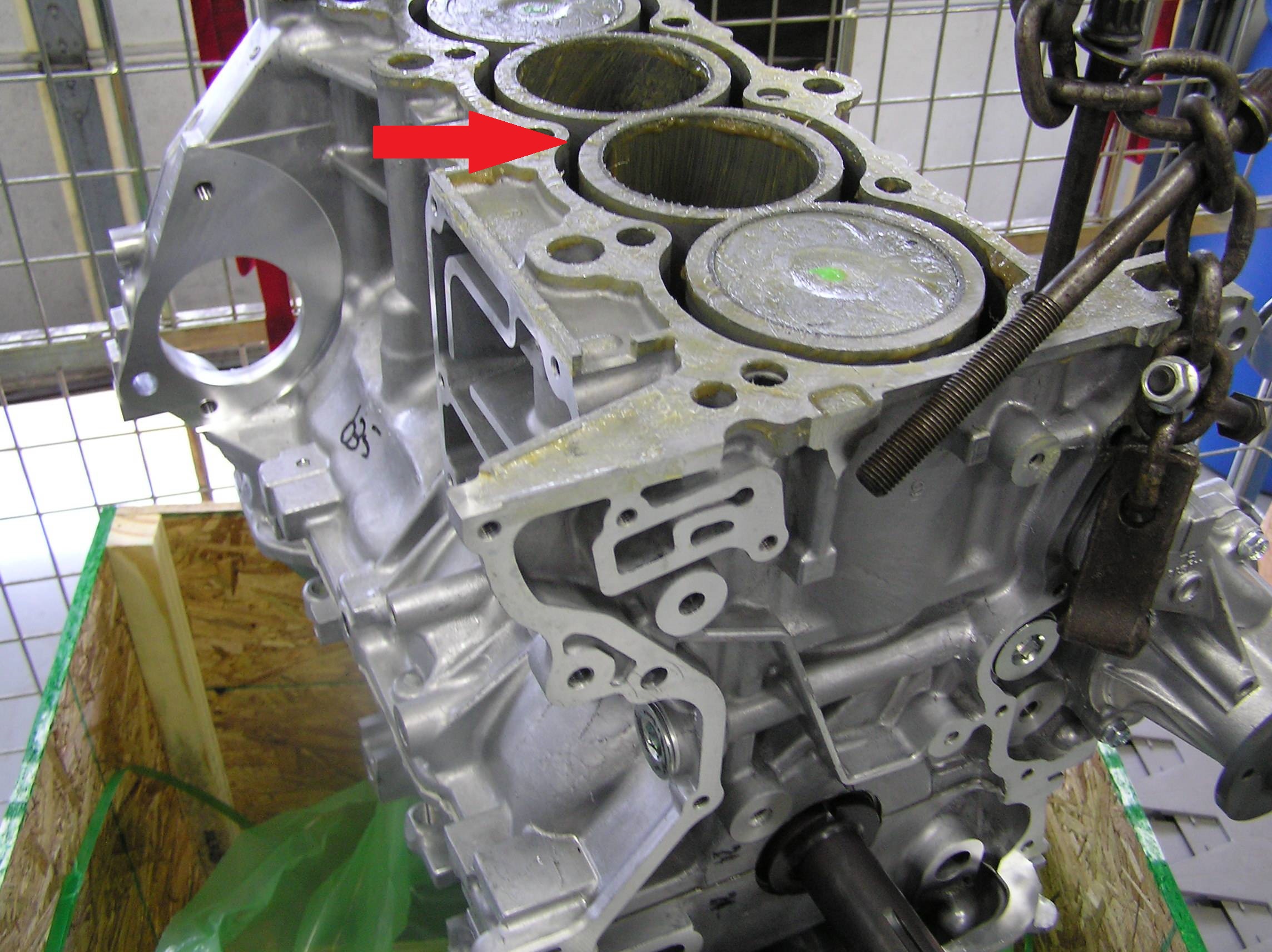

Water jacket, you can see it on this brand new block

Alright, so if i'm understand correctly (sorry for my lack of knowledge)

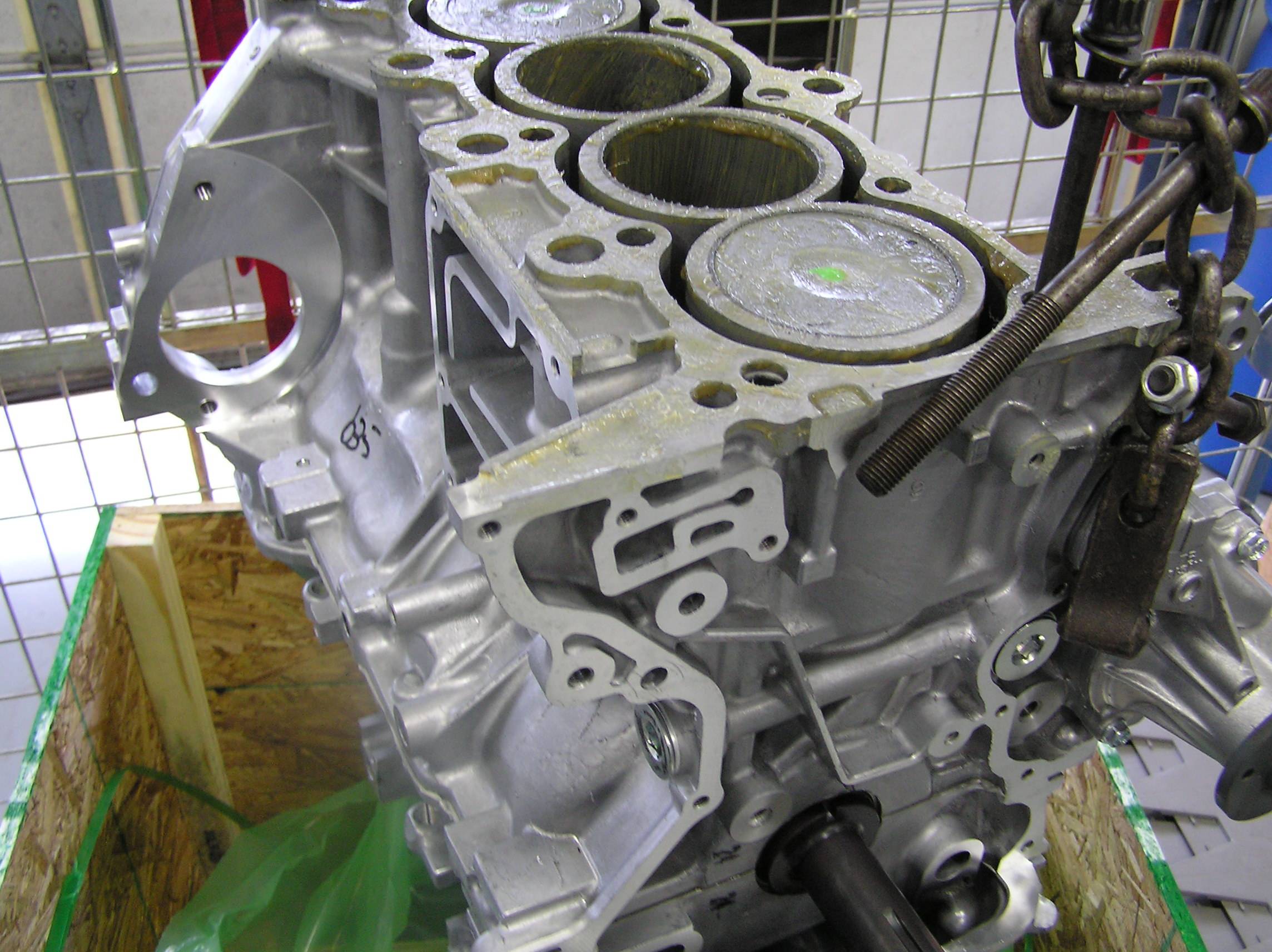

This is the water jacket? It surrounds the cylinders and cools them. The head gasket which would lay over the top of all of that is blown, causing coolant to rise over the top and flow into the cylinders?
Arrow is correct. (I'm too lazy to do MSpaint and reupload at work LOL)
Not quite. You are only seeing half of the picture there, the head isn't in place.
Cylinders completely submerged in coolant all the time there is more like it, coolant is not only surrounding the cylinders but also flowing through the cylinder head.
Cast aluminum and steel are pretty stout, reliable, and rarely fail (until a severe overheat), and the head gasket is the (consumable) item that is supposed to maintain a seal between the:
cylinder and combustion chamber (block and head),
that mess is separated from the coolant,
all the above are separated from the crankcase passages,
and all the above are separated from oil pressure passages.
AND all the above must stay sealed between the block and head.
So that gasket has a lot of different things to do.
Some designs might incorporate even more areas that are sealed and separated.
