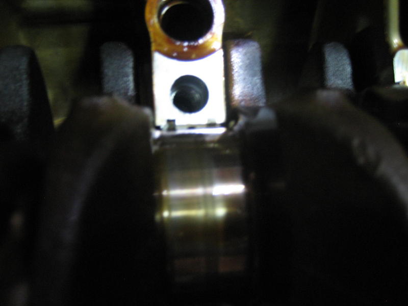

All I can say is I wish I had changed my frigging rod bearings a long time ago. It is like a a different car! Got some pics for anyone out there with experience to weigh in on. Also, I gotta figure there is a way to do the mains in the car. Thinking I could get them out fairly easy, run a small strip of rag to clear most of the oil get the new one in and plastigage. However, I've seen the "taste great, less filling" arguments on this all over so interested in that opinion as well!
Had a tough time getting shots of my rod ends and the crank because of the light/camera issue but here are some shots of my main bearings and best I could do on the crank. I didn't plastigage the mains because I was worried that without access to the other side to clean them I might get false measurements. However, I think the bearings are OK but basing that on bearing pictures in the Haynes manual.
I did plastigage the rod bearings and they all came in well within the service limit.
You had the main web off, and didn't change them? Did you have the engine out of the car at that point?
Not sure how tough it would be to do on that particular engine IN the car (not a common job here), but I have done it on various other engines in the past.
Play it by ear....Goes kinda like this:
Loosen all the main caps so the crank drops ever-so-slightly but you don't ruin the seals (torque converter or input shaft will hold up one end, oil pump will hold up the other so there can't be much drop),
remove main caps one at a time,
roll (push) the upper bearing shell out, and back in, and seat it with your fingernails (and maybe a pocket screwdriver).
Install the lower bearing half in the cap,
oil,
then reassemble loosely.
Repeat for the rest,
then reassemble.
Did my old Quad4 this way but couldn't get the rearmost main changed (thrust brg IIRC) without removing the crank. Did all the rest, it lived several years that way.
Yes, I had the bearing cap off and didn't change them. Engine was in car. I was after the rod bearings this time and wasn't sure how to do the mains because I didn't want to pull the engine but I didn't have the code on the engine web. After pulling the rod bearings I realized you can still see the original color. Next time...
I appreciate the method you listed. I think it would work for my car but I'm bumming a little bit because I had the oil pump off also to fix the little o-ring and it probably would have been pretty easy as the crank was just hanging there. Live and learn.
