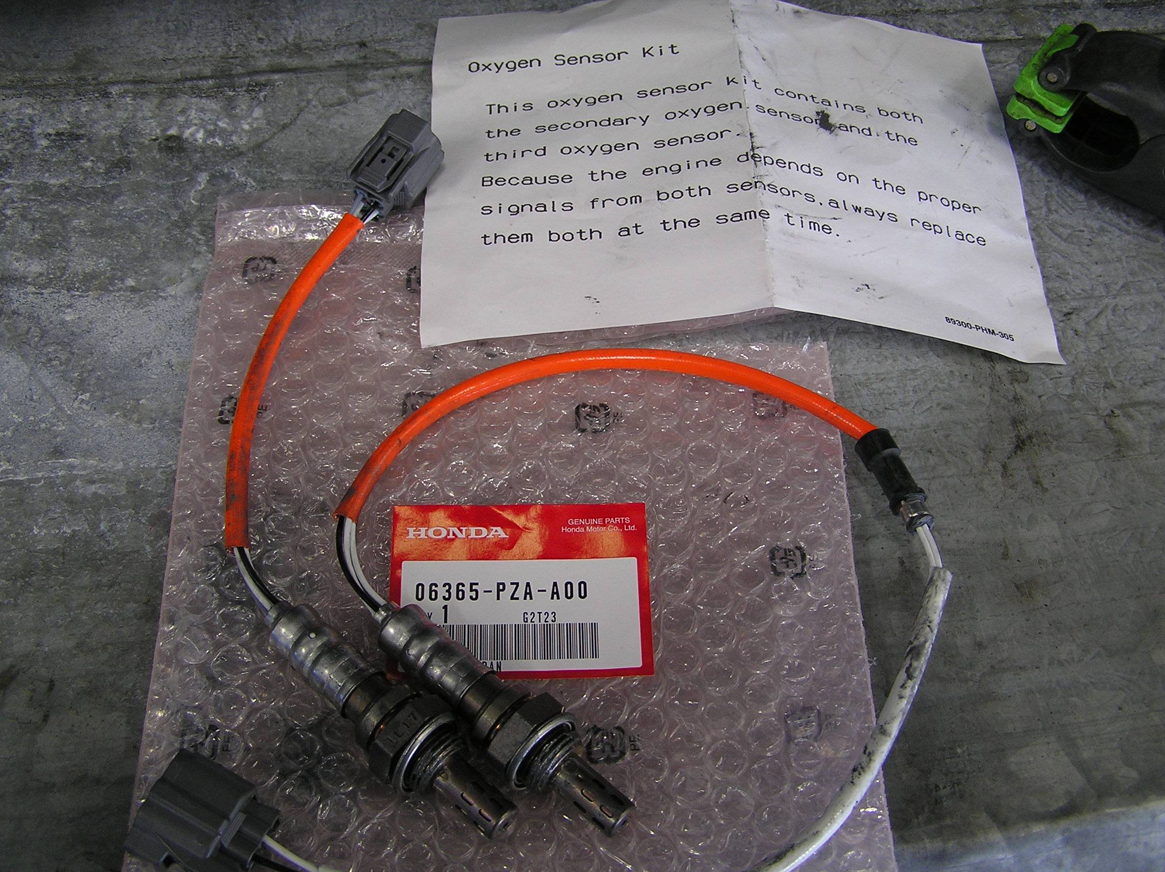

Here's a pic from a matched pair I put in a hybrid the other day (sensors #2 and #3). Read the note that was included in the package (Left pic full size for clarity....and I'm too lazy to resize it.) These were NTK brand in the package.

I said the 2 rear sensors I just put in a HYBRID were NTK.
I have NO way of knowing what brands were original to YOUR car without actually ordering them and seeing what comes in the package.
The note said nothing about the first sensor at all.
The first sensor can be replaced by itself.
The middle and rear sensors are to be replaced as a set.
I worded this wrong... I really have no way of knowing what brand was originally installed at the factory, and the replacement parts may or may not be exactly identical to the original.... But if Honda says they will work right, I have to trust them (and I have actually had our people make phone calls all over the country on occasion JUST to make sure). Sometimes things are updated or improved, or maybe they just change suppliers for whatever reasons. IDK.
Originally Posted by dr_dx
In your experience, when you have replaced the AFR and the O2/s on the same vehicle with the factory parts, have you noticed if the parts were the same brand or not?
They have matched on the occasions where I actually look. I don't always look because I use OE parts so unless there is a glaringly obvious issue I just install and trust the factory parts.
In your experience, have the factory AFR and O2 parts for the D17aX engine been predominately NTK brand or have you seen other brands i.e. Denso, Bosch, etc.?
I'm used to seeing DENSO, and NTK because both were OEM suppliers. Those are the ONLY brands I have ever seen as OE O2 sensors on Hondas.
I strongly protest when someone wants to cheap out and use anything else, but there are occasions where I see factory parts that have been reboxed and sold through discount parts stores. That's hit-and-miss though, the counter help rarely will look and tell you what you are getting.
