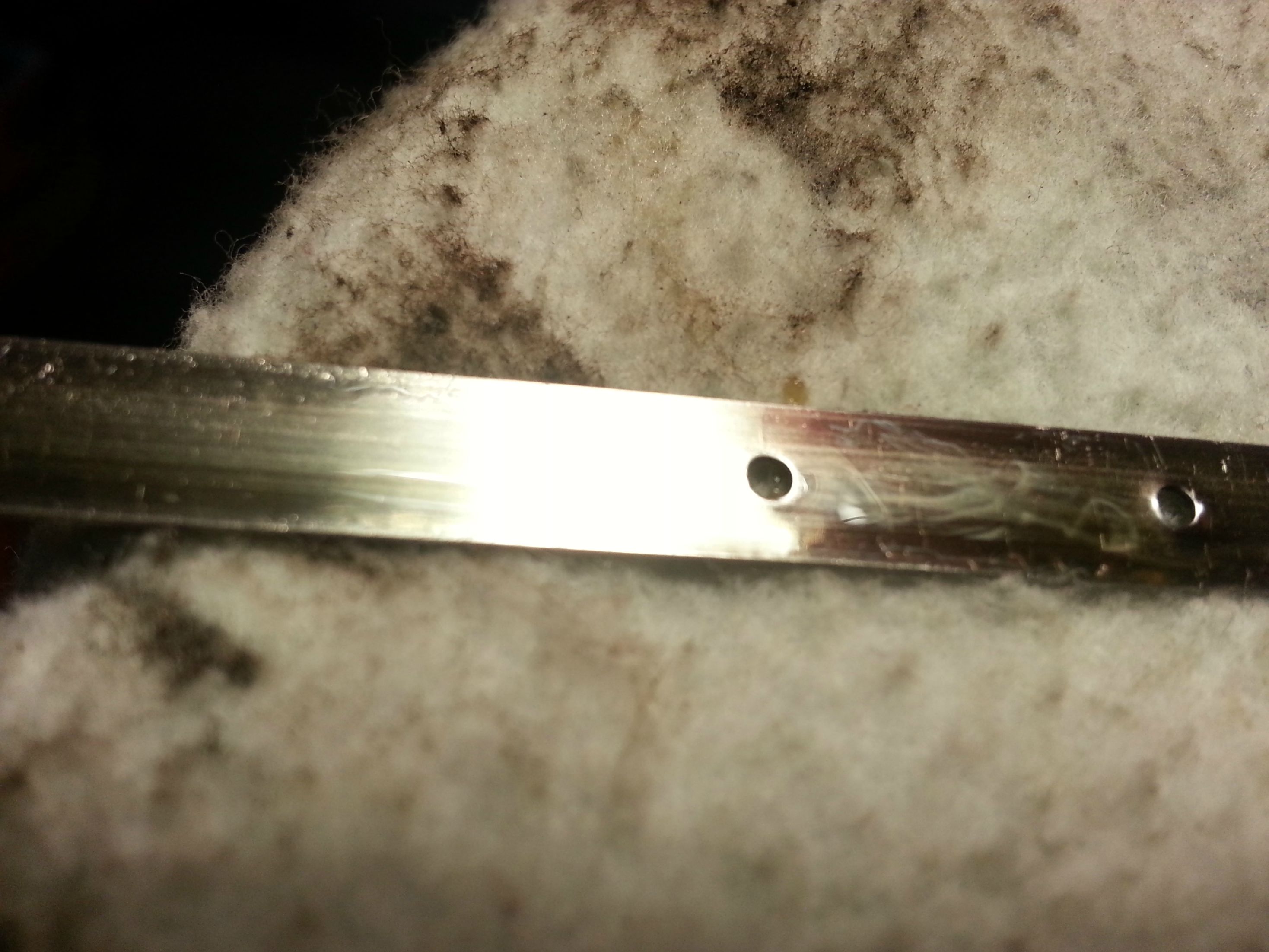

Do you have any thoughts on the streaks on the dipstick? i thought the engine was dry when i put fresh oil in, but it could be left over water. i'll do a coolant system check as well to rule that out.
I can't see a dang thing from here.

Re: Car ran through large puddle, internal coolant leak?
Here's what it looks like:
Old Apr 7, 2013
Rep Power: 518
That's interesting. I have no idea what that is...
Not real sure that I'd be worried yet though.
How long has the engine been run since you changed the oil?
