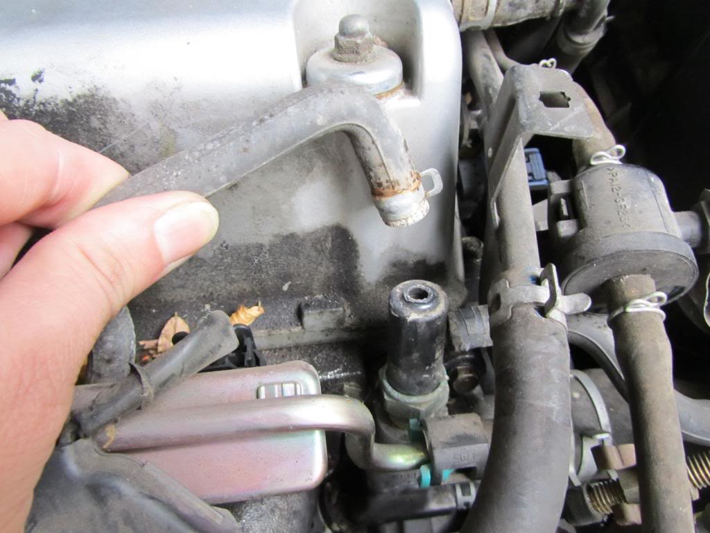

My daily driver is an '03 Acura TL-S, but I am now in the early stages of fixing up a 2003 Civic Si which has been sitting for nearly 5 years. I have the car running but one item I need to replace is shown in this picture. It appears to be connected to the cooling system and sits just in front of the valve cover on the driver's side. It is plastic with a metal base and the stem has broken off inside the hose. Can anyone tell me what this part is and where I might buy one?

"air assist valve"
Looks like you may have to buy the water outlet assembly to get it.
http://www.hondaautomotiveparts.com/...+PUMP+-+SENSOR
Item #9
19350-PRB-A00
HTH

Thanks for the help!
