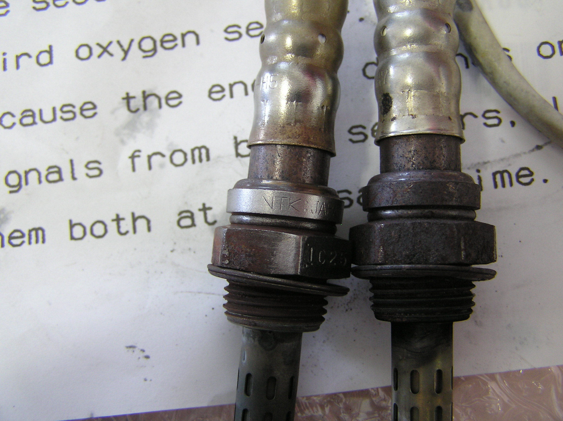

Here is the two I pulled from underneath.
OHF 545-H5 and 545-H7 I think were the numbers. I replaced these two with NTK.
Looked at the front one, Denso. Bought that Denso, paid the extra $3.99, it'll be here tomorrow, then I can move on to the next life-changing decision. I appreciate all your help!

Hit those sensors with a wire wheel on the ring where you see NTK stamped in my sensor, I bet you'll find NTK on yours too.
The front AF sensor says DENSO on it, I'd keep it Denso.

Yep kept that one Denso. Interesting that if the rear pair of O2 sensors were factory, NTK, that there was a mix-and-match.
