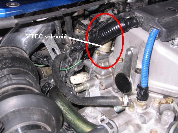

It would be nice to know the exact code that's being read.
You may have a problem with your VTEC unit located on the back left side of the cylinder head if you're looking at it under the hood. The two major parts are the solenoid itself and a separate oil pressure sensor used just for VTEC. The car won't go past 3500 rpm or so if VTEC is not working properly. It will feel like there's a governor on the car, which is basically your ECU keeping you from causing damage to the engine. It still does sound electrical and intermittent at this point, but there's two connectors on the unit, one for the oil pressure switch and the other for the solenoid. I'd disconnect them and spray some contact cleaner in them. It could be as easy as a little bit of corrosion. Worst case is you have a problem with the solenoid or the pressure switch. There is also a screen to keep crap out of the vtec system. It could be clogged, but I think your problem would be more consistent if that were the case.
Pictures for reference below:

Wow, Matt, thank you that was very helpful. Pictures and everything
I didn't catch the number of the exact code (I think it was 1259?? I googled and found this on this same site: If the engine oil level is low, the engine computer turns the engine light on (Code 1259) and does not allow the engine RPM to go above 4,000. That sounds like exactly what I am experiencing. The employee mentioned what you described-something about a VTEC solenoid and oil sensor. When he plugged it up, it said "definition not found" but he went inside and looked it up and said it was as he thought, something about valve timing with the VTEC. I guess I will find out for sure tomorrow when I see the mechanic.

P1259 VTEC System Malfunction
You said you're loosing oil, but it sounds like your monitoring the level, so low oil level doesn't sound like an issue at this point. However, if you have some sludge build up, pressure may be an issue. If the VTEC oil pressure sensor doesn't sense enough oil pressure, it won't engage VTEC and the ECU (cars computer) will put you in limp mode.
If the VTEC gasket screen is clogged up, that will probably give you a glimpse of what's going on overall in your engine.
I'd tell you to run some full synthetic oil, but that will cause all kinds of other problems. It would start to clean the engine up, but it would probably cause all kinds of leaks from cleaning up crap around the o-rings and gaskets.

Here is what I found out at Auto Zone:
P1259 - VTEC System Malfunction (same as last time...)
Possible Causes:
Open or Short Circuit Condition
VTEC Solenoid Valve Fault
VTEC Pressure Switch Fault
Blocked Oil Passage

going by the new info you provided, the problem could be in the VTEC system also or a combination of that and the sensors, impossible for me to diagnose on here, i can only make educated guesses with the info provided,

Cam Position Sensor has nothing to do with a P1259 VTEC code.
P1259:
The computer did not detect that the pressure switch changed states when the VTEC solenoid was activated.
Possible:
Solenoid
Valve
Pressure switch
Wiring
Insufficient oil pressure for the system to operate.
If this thing works most of the time but randomly doesn't-- and sets the code, I might take a wild guess that the pressure switch is flaky.
A used engine might be a crapshoot too. Maybe go for a new engine under warranty? At any rate, you will still need to check your oil regularly.
