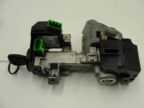

2 bolts hold it to the column. No hex on the bolts, they look like small cones. The hex heads are broken off during assembly (tamper resistant).
Generic Honda column lock assembly, not quite like yours, but similar. (Upside down too.)
You should see this clamp holding it to the column.
HTH

You did NOT just get that off of there while I was in the McDs drive thru, did you?
Remove the black things at the end by the key. Reconnect them to the car. Stick your key through the hole and let it dangle there. This lets the immobilizer read the key.
Remove the ignition switch from the opposite end. Plug it in to the car.
Use a screwdriver to twist it to start the car.
Drive to the dealer or a lock shop.
You will need new screws or adapt something else to reassemble the mess to the column.
HTH
HTH
LOL. No, not yet. I just got a pic of one so I could see it all when it's out. I think I need to wait til tomorrow to pick up the disk for my rotozip. Unless I can drill the bolts out? I have to read about those a bit more. I'll time myself though. Lol. Shouldn't be too bad with just the 2 bolts and a few clips

well, I ordered an ignition switch. It's the exact one in those pictures I posted. I'll be taking the broken one off tomorrow. They will be able to program it even though it's a used one, right? I really hope so

Re: HELP! 2004 Civic SI
HTH
Tomorrow i'll be trying this. If I can get it to run with the screwdriver than I can drive it to the dealer, put the new ignition on and have them program it. should be good to go at that point. That would be perfect. Off to work for today. Hope it goes good tomorrow

A used unit can be programmed. I hope you got plenty of keys with it.
Did you check the fee for programming at your dealer?
Old Apr 19, 2012
RobertBaldwin's Avatar
Trying to get this 2004 si on the road!!
Joined: Apr 2012
Posts: 30
From: Sterling Heights, MI
RobertBaldwin is an unknown quantity at this point
They said it was $50 to reprogram. I think the ignition is only coming with one key :/ I'll have to see how much the dealer will charge for an extra
Old Apr 19, 2012
Rep Power: 520
Only $50 to do the programming?
Wow, that's reasonable.
I expected to hear double that, at least.
I see $46 list price for a black headed key (master).
$18 list each for a gray valet key (this is all you need since these keys will ONLY be used in your ignition, don't waste coin for an unnecessary master key that can't fit any other locks in the car).
Part# 35114-S9A-A01
Call ahead, they may need to order valet keys since most people want master keys. Order the blanks ahead of time if necessary.
No idea if there would be a fee for cutting them. We don't charge to cut them if you buy them here.
The new ignition key cannot be cut by the VIN of your car though (Honda keeps records of this)
You REALLY want to obtain the VIN from the car this used part came from for your records (if you lose the keys!!) And sometimes it makes cutting fresh keys easier since there is wear on the original keys.
Cutting by code can be better than duplicating a worn key.
Program them all at the same time, fee should be the same regardless of the number of keys.
If the guys have to connect the scanner a second time, there are usually more fees.
HTH
