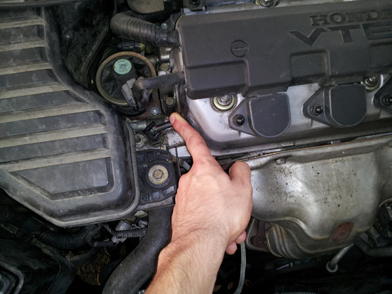

Thanks for the reply. I dug around a bit based on your response and I think I located the sensor. However, before I go ahead and replace it, I wanted to confirm if what I found is indeed the Engine Collant Temperature Sensor. I am pressing on the wiring for the temp sensor (the sensor itself is the small thing to the left of my finger)
I took a picture of it. Can you please let me know if it is the ECT sensor that I am holding the wiring for in the picture (I think the big black cap thing which has Seimens written on top is the EGR valve).
Can you please confirm if that is the ECT sensor?

As long as the wire colors match what I posted from my wiring diagram info above, then you can assume that that is the correct sensor. And yes, it looks right.
And yes, the other thing with the sticker on top is the EGR valve.
