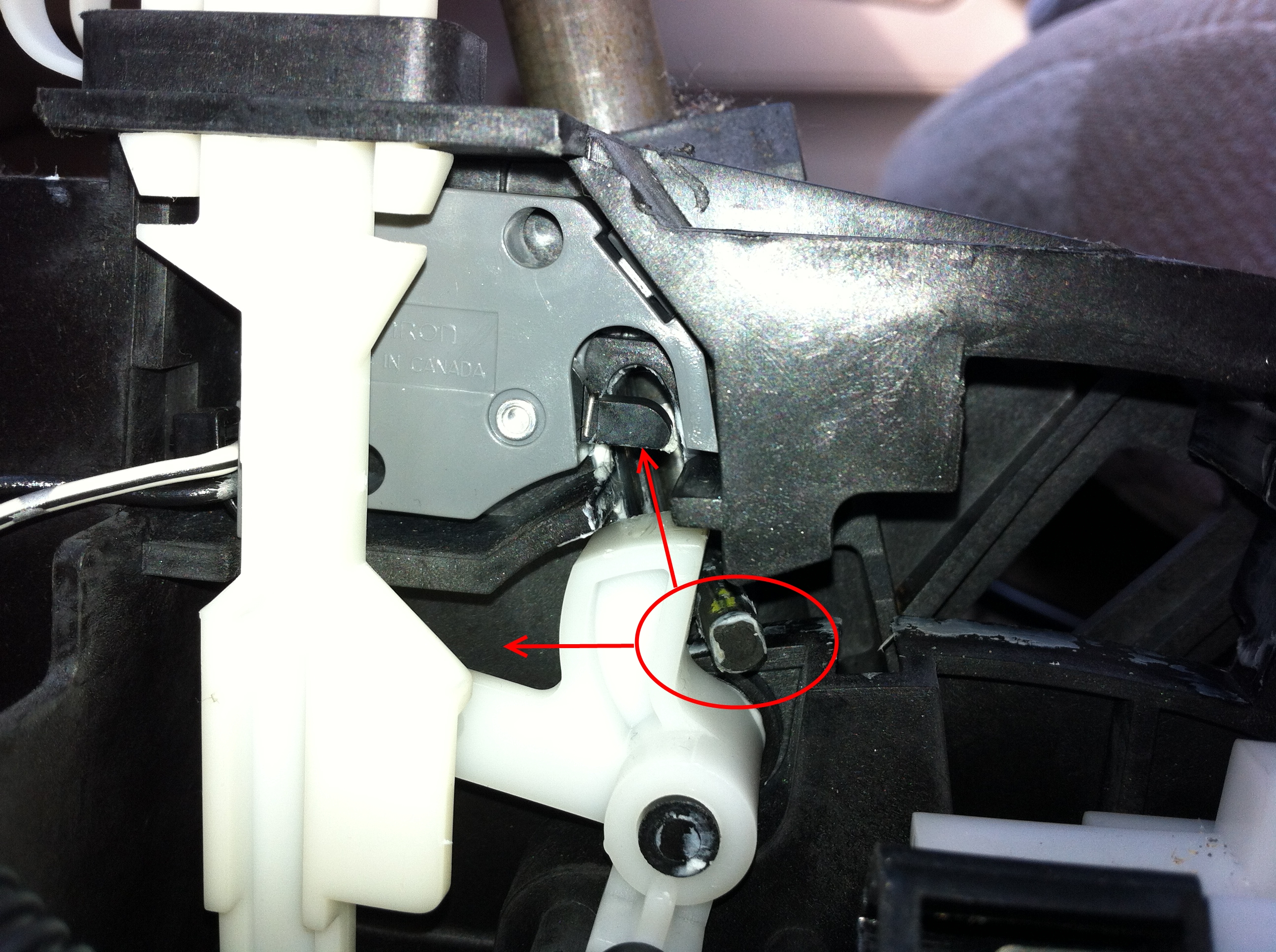

So, I believe I found the culprit. If you look at the picture below, it seems as though the pin circled needs to slide forward and up when the car is in park. I validated this hypothesis by turning the car on, leaving it in park, and activating the black finger switch attached to the gray body. The key was easily removed from the ignition.
Now, the questions become:
A) Can the pin be fixed or do I need some replacement parts? If replacement, do I need to buy the whole base or just the shaft that the pin is part of?
B) Still no conclusion on whether the radio will work after reassembly. Any ideas?
