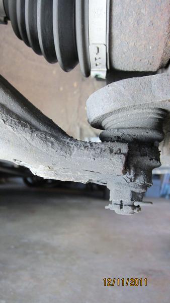

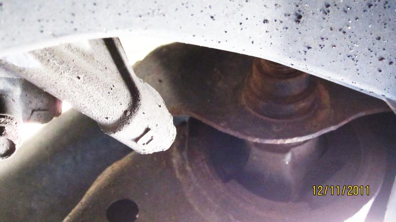

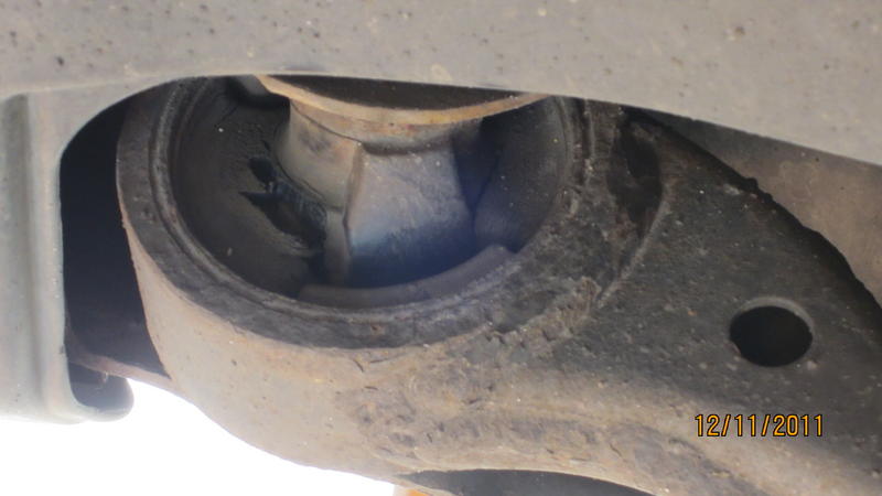

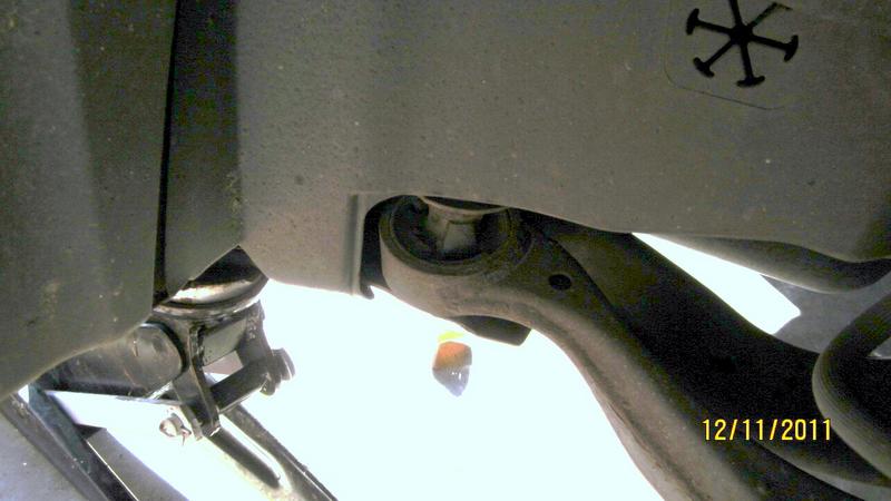

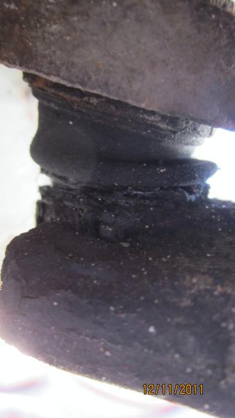

After getting no responses, I perused the forum and found that my lower control arm bushings are the likely culprit.
I have attached pics of the driver side LCA bushing as well as a few of the DS ball joint.
My questions are;
Should I replace the arms (and who's with) or try the urathane solution that another poster came up with?
Does the ball joint typically gets changed out at the same time?
Thanks in advance for any input.
JAB

Thanks for the info, Gunner. I appreciate your time<smile> The arms do look a little worse for wear, a little rust at the welds, but as I look further into it, I see that some co's do offer poly bushings that can be pressed in the the existing arms. I am thinking of pulling them both, removing the rust (it doesn't look like it is anywhere near structurally damaging at this point) painting them up, pressing in new poly bushings in the front, installing new poly bushings on the rear of the LCA and replacing the bearings. Bearing (pun) in mind that the car is for commuting by a non aggressive driver for 80% of the time, and also hi demand hwy driving by yours truly the other 20% of the time, what manufactures would have the appropriate parts for the above? I guess what I'm asking is who makes a good performance bushing/bearing what while not for the track, will give us good all around performance and is poly. Thanks again for reading.

I'm not sure if the aftermarket bushings will last longer but they will make the car handle a bit better, more responsive. If it gets cold where you live I'd get OEM bushings, the aftermarket's can be noisy in cold weather from what I've read. Your bushings are 9-10 years old so it's not like they're not made well.
If you haven't replaced the ball joints yet I would while you have everything apart, either get moog's or OEM.

Not for nothing, but I dont think thats your problem. They are slightly torn but mine were much worse and they didnt make any noise. Check your front engine mount. I bet thats the problem. Or it could be that ball joint. I reccomend pressing in new OEM bushings into those arms. I did mine with a piece of metal shaped to the new bushing and a heavy duty bench vise as my press along with a huge pipe to close the vise. It was a bit butcher but it worked for me. Still need to remove the arms however. Its up to you.

@Anibis, I am in western PA so it gets cold, they LOVE salt! So I will stick with the OEM's as you suggest. Thanks for the feedback.
@04 Honda Civic, I tend to agree with you about the bushing not necessarily being the source of the noise, as i hear it to dif levels on both sides of the car, and the PS LCA front bushing looks pretty much ok.
