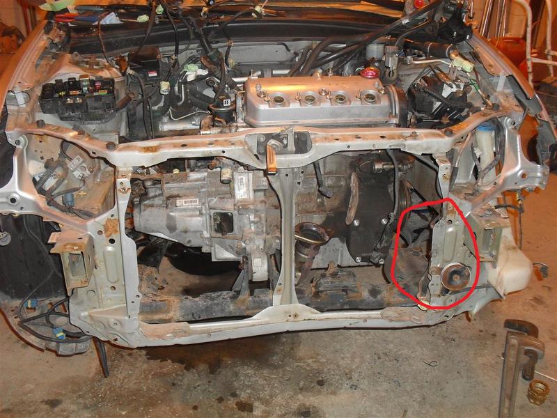

I understand it needs to be properly recharged, but what does that mean? Fill it till it says its at a safe level on the refrigerant gauge supplied with the can of refrigerant, or some other way? And oil,is that the little cylinder next to the fans? Can I do this, better yet can i get the oil to fill it?
Located here right?

Did you let it out fast? If you did there is a good chance you let alot of oil out. The only safe way to put the proper amount of oil in is to flush the system out and refill it with the proper amount of oil. TOO MUCH OIL IS JUST AS BAD, OR WORSE THAN NOT ENOUGH SOOOOO
, Don't just pour some oil in a think its ok. The amount of oil is a calulated factor. The refrigerant "carries" the oil through the system. To much and it can't carry it all. To little and it is just like running your engine with not enough oil... Aside from that you need a deep vacuum (30" of Hg) on the system for atleast 30 minutes or so to get extra atmosphere out and to vacuum moisture out. Moisture is death to an
a/c system. It mixes with refrigerant to make acid. In short not discounting your abilities at all, but if you don't have a firm grasp on air conditioning theory do not attempt it, fixing any mess ups is not cheap at all. Trust me (been a certified a/c tech for over 10 years), by far the most expensive a/c repairs I have been involved with have been the ones that someone who thought they knew what they were doing and didn't it......
