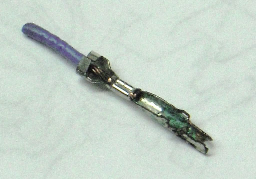

Removed wires from harness connector using SnapOn tool. Blue wire is corroded passed the crimp area on the terminal pin.
Spent 1.5 hours at 2 dealerships looking for new terminal pins. Seems 2004 is too old! No part numbers, no kits, no nothing. Both dealers said that they save the old engine harnesses (when a customer pays for a new one) and cannibalize them when they need a connector

Didnt look this bad inside the connector

OK. All is clean, good connections to CKP, no more open circuit.
