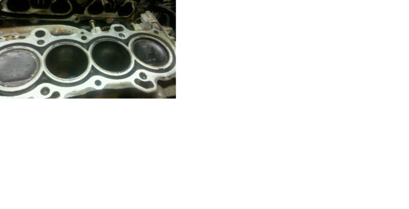

Ok guys,
I took the head off my civic this past weekend and found piston one about 3/16" lower than piston 4. Bent rod I would assume.
Also, the motor was at tdc on piston one ont the compression stroke and when I looked at the underneith of the head, cylinder 2 exhaust valves had one open and one closed. Compression was normal on the cylinder. Is this normal. I can't see the cam through the rocker arm assembly to see if the two exhaust lobes are identical.
Would you guys say bent rod?

Re: 04 civic lost compression
Originally Posted by yfz45004101
Ok guys,
thanks,
Ian
TDC on this engines is piston tops are flush with the deck. If ANY pistons don't come all the way up there is NO doubt you have a bent rod, maybe more, spin it around and watch them all. You are right though, 1,4 and 2,3 are on the same through of the crank (different strokes of compression, but same position in the block...
The good thing for you though is there is no reason to pull the engine if all you need to do is replace a rod or two. You are halfway there, pull the head and the oil pan and knock the hole assembly out the top. If you have a ridge on the cylinder take it off first, but unless you have a bajillion miles on it it will be fine.
I had my civic head off a couple months ago and it had zero wear in the cylinders, could see the crosshatch still. It has almost 150k now. I also had the b18 apart in a 90 integra I had and it still had it too. It had 130k. Honda must have some really hard cylinder walls. American engines, particularly "V" engines have a lot of cylinder wall wear by those miles. The "inline" engine are better though.
