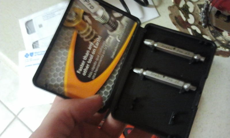

Dude, I just did that also, the one torx on the left came out with no trouble, but the right one stripped
I went to home depot and got this e-z out type thing, and I'm in the process of drilling it out now. It just got dark outside and I gave up for the night, so I'll continue tomorow. I pray that it'll work cuz I just got this new steering wheel from a member on this forum, and i can't wait to swap it out
But to answer your question, like lazlong said, disconnect the battery cable and the horn won't sound anymore. Good luck taking the screws out, obviously I didnt have much of it.

I saw you bumped his thread and mentioned the steering wheel had just arrived, was expecting a thread or a comment like this later. Steering wheel swaps never seem to go well on our cars for some reason.. Good luck with the ez outs, be very careful not to break one off because then you are truly in trouble.
A lot of people have trouble getting steering wheels off, so it's a good idea to pick up a steering wheel puller using one of those deposit-rental programs at a parts store. Just a tip.

yeah I know, I'm kind of stressing lol, but if I don't manage to take the screw off, some shop around my house will.... at least I hope so lol. But yeah, I'm down to do a DIY, although I have a stock steering wheel, so it'll be just a simple replacement. One thing I have to figure out is how to post the pics after each paragraph, and not in thumbnails
The screw I'm having trouble with is the torx screw on the right side that holds the airbag, so we'll see how it goes tomorrow lol
